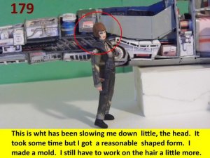

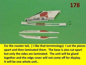

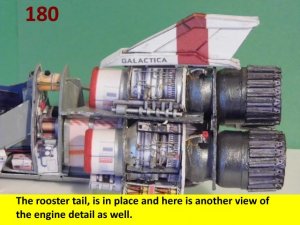

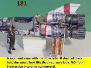

I do not have too many photos for this posting and that is due to the time consuming construction of a feasible head for my Viper Pilot. It is hard to make facial features, at least or me. It took a while using FIMO clay but I made a good copy and made a mold of it. It will serve as the basis for future heads. Originally I painted the hair black and had a chuckle to myself. For those here in the U.S. the head looked like FLO, a female actress for a Progressive Insurance commercial. The tail section (Rooster Tail) will be a one piece glued together unit. I was going to add the wiring and greebles to it but opted out. The landing gears are off for now. The gears will be attached after I do the skinning for the bottom. Enjoy and see you all soon with more updates.
For the rest of the guys, keep up the great work and waiting to see more of your stuff as well. Enjoy and see you around the forum.:thumb:

Great work, silver! BTW, I think I'm gonna "borrow" your idea to make 3D rounds; I'll give it a try using some toothpicks.

As for your sculped female pilot, she looks better then anything that I could come up with.

That is what my build threads are for, go for it. The linkage for the rounds are colored in when the glue sets. Mine are a bit wavy but it still simulates the round linkage. Also, the tray is different from the plans but still simulates the feel of an ammo tray with 20mm rounds.
As for your Viper, the more you work on it, the more realistic looking it becomes.
Thanks, I am still playing around with Tiricks figures. I am playing around with the scale to get one as close to my figure. I may do a back to back thread on his and mine

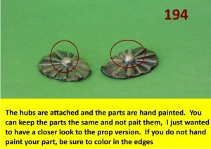

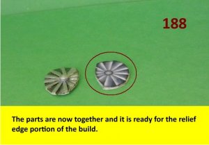

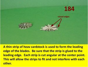

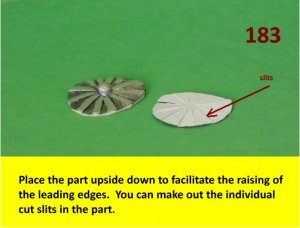

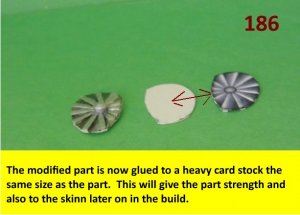

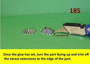

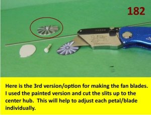

Here are some more updates on the Viper build. UHU gave two options on the fan blades, Here is a third option which is easier for making the raised edges and do not have to work with those pesky little tabs.
I will be back with the second posting of the fan blades. The blades will be shaded in better when the glue sets.:thumb:

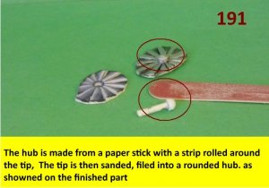

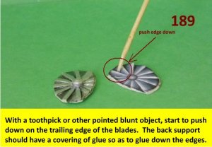

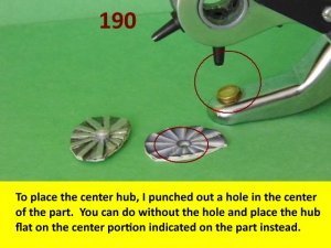

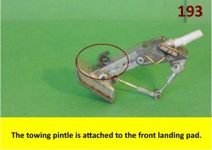

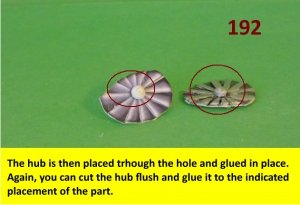

Here is the next batch of photos on the fan blades, as well as the front landing skid. I forgot to add the tow linkage earlier.:thumb:

@Silveroxide: The fans look GREAT! The landing gear looks way too realistic! I like the added tow pintle on the front.

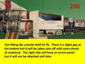

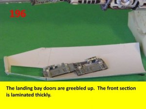

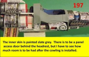

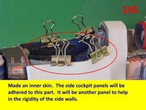

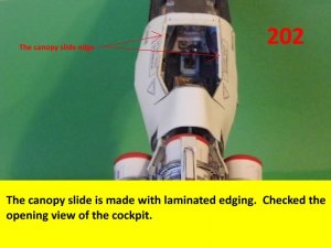

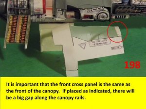

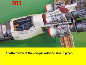

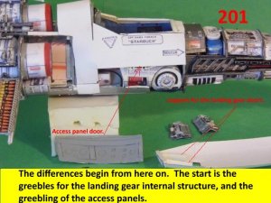

Thanks for the compliment RB. I just happen to do things my way and use the models as a base in which to further work up the details. UHU's design are perfect, but once the Viper is enlarged, it cries out for more detailing.
The viper is coming along nicely, but if you want to make it canon, my enlargement will not work with the slide on and slide off skin. My intentions are to attach the skin permanently at strategic points. Enjoy and see you all soon with more updates. Come on guys, you are slowing down, I will catch up to to you all. Enjoy and see you all around the forum.:thumb:
