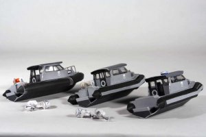

I'm getting to the point in model making were I start to lose interest. The major stuff is worked out and I'm down to tweaking and working out the fittings and details.
At this point my efforts are spread over three builds. As I work out a detail I put it on the earliest of the three first and then put the improved parts on the newer versions. The Engines still aren't attached. I'm starting into wire work for the railings and the like. The older version is on the left and the newest version on the right.
I am considering putting little LEDs on a model so that it lights up.

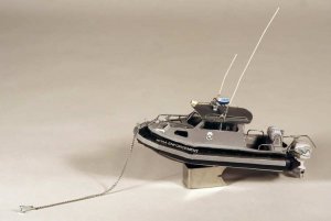

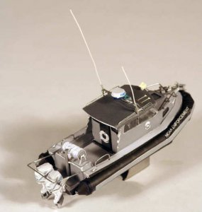

I'm still working on this craft.
Here is the latest version. This one has a functional chainlocker. The propellers turn, the motors lift and swivel, and the winch spool turns. Oh and the door opens.
Don't look too closely at where the sponson meets the gunwale or at the curve of the hull.

That's fantastic. What is your modeling process? Do you use a CAD program or do your draw the stuff out? The "floatation-sponson-tubey-thingys look great!!

I'm pleased that you like it.
I use Coreldraw with trial and error. I photographed the vessel, imported the photos into Coreldraw and drew elevations over the top of photos estrapolating the parts that I didn't have views of. I enjoy the extrapolation part: finding the manufacturer's website and visiting marine supply stores.
Then I drew the formers and keel over the top of the elevations and started into the trial and error part--lots and lots of prototypes.
