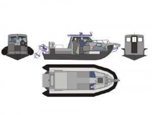

I went to the Alaska State Fair yesterday and NOAA fisheries enforcement had a booth with one of their boats on display.
I might work up to making a model. Doing an elevation seems the best first step. I'd did this drawing based on the photos that I took.
--Lizzie

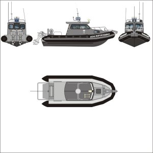

Onward with this possible model. I now have the "floor plan" and the front and back elevations.
I've made another trip to the State Fair for more photos. A friend of mine has become interested in it and has been asking questions about how the pontoons attache to the hull. There is another word for the pontoons which I can't remember right now. It starts with an s.
Here is the current drawing. I still don't know how far I will take this in making it as a model.

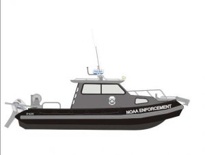

On ward with this model. I put the drawing into layers so that I can take off parts of the drawing to see the insides. Here are some of the layer that show the insides.
That's pretty much done, so now I've started lofting the hull (designing the formers).
Last night I got eiger and did a rough build of the hull. Lots of stuff looks like it fits in the drawing but doesn't once I'm dealing with the thickness of paper.Whoops!
I put the people in for eyeballing scale. Since I built this from photos I need to know the size of something in the model and people are the easiest for me to see. Got to make sure the v-berth is long enough and the seats the right size.
--Lizzie

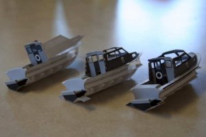

I don't know if anyone else works the way I do. I design by doing repeated builds. I build up to the point where I need to figure something out and then starting over again make changes in the process.
I'm up to build number 4. Here is a photo of builds 2 through 4. I didn't include build #1 because it didn't hold together very well.
Before I do the sponsons,I first need to work out the shape of the prow. The prow is still messy, and I'm not yet clear about location of formers and how they meet with the deck and v-berth interior.
I'm going to do the full interior which will be fun with glimpses seen through the windows and portholes.
Oh the models are each 5" long. The beam is 2". I don't know the scale. I calculated it at 1:60 but then increased the size by 6% to match my other models. I use the human figure to calculate scale.

Lizzie, I do my design builds almost the same way (like the Agincourt.) For most of them, I usually stick with the original build unless something really comes out badly. Some of mine have 3 or 4 incarnations before anyone else sees them.
The boats look great so far. I agree with Bowdenja, really interesting subject.
Scott K.
