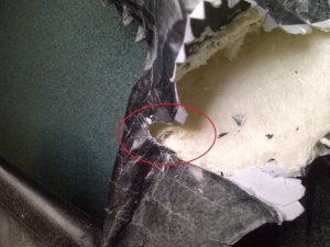

I made sure that I did not use too much. I first filled the neck cavity around the cork on the end of the main armature. Then the upper arms, and then the main body cavity. When the foam is still soft, I noticed (too late) that the moisture in the uncured foam soaks into the paper of the model and softens it. So, when I was adjusting the internal armature and making sure everything was in the correct shape, the softened paper tore in places. Luckily, I can replace these pieces.
You can see in this picture what I mean.... The circled area shows the worst tear... You can also see the cured foam inside the body cavity.

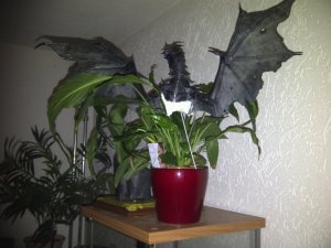

I shoved the bottom of the armature in a plant pot, and attempted to hide the dragon from my cats in the leaves of the plant, on top of my display case.:cool:
This dragon model is HUGE!
