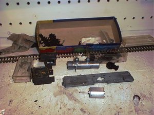

Wipers
Shamus,
I've not seen photos of the wipers, no photos in the catalog.
How do they attach, what gauge of phospher bronze, etc. are they made of. Anything larger than 0.010 diameter wire is too much pressure on each wheel.
If you have photos, please attach or send to me.
Thanks,
Marc
shamus
Registered Member
Dec 17, 2000
3,489
85
UK
Hi Marc,
They come 6 on a sheet, enough for 1 shay or a three trucker.
Shamus
marc gast
Nov 16, 2003
123
67
Grand Rapids, MI
hometown.aol.com
Wipers
Sham<
These look pretty good. There are actually only enough for 1 MDC shay as each truck uses 2 wipers unless someone wanted to add pick-ups to the an MDC 3 truck shay. Looks like the pick-up wire is soldered to the top of the mounting area.
On my wipers, I solder 0.010 wire on the under side of the fold and bend the wire so it is between the two wheels, not pressing down on the top.
I may give these a try out.
Thanks,
Marc
shamus
Registered Member
Dec 17, 2000
3,489
85
UK
Yes you are right, only enough for a 2 or 3 truck shay.
Toooooooo much liquid refreshment over Xmas.
Shamus
