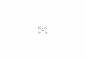

Here is a small unfolded 4 mm dome, if printed on A-4 paper. It's small, but should give you a nice dome, or a mold to put some two part epoxy into. They are incredibly small, good luck!! :)

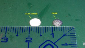

Another thing that you cando, is cut out a circle that is about 5mm in diameter, then take a roundeddowel (like the end of a small paint brush), and form the circle into the domethat you need by GENTLY pressing it (in a circular motion) in a thin foam pad(like a mouse-pad) to form the dome.
Either way you go, I wish you the best of luck with it.
Yep, that technique works very well. I used it to make the bumpers (or whatever they are called) on my E92 Elekrtolokomotief model.
If you dampen the paper slightly, this helps to stretch it. But, GENTLY does it...:mrgreen:

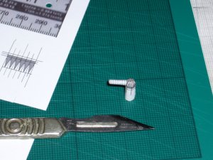

Much delay, as usual, I've done a bit more and another step nearer completion.
Hi John, thanks for the domes, but I couldn't cut them out accurately never mind doing any justice to making them, so went back to petal folding. I did use the cut out circle and domed slightly (thanks guys) underneath the petals to glue them in place. Still needs a bit of work, but in theory seems to do the trick.

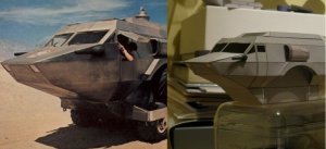

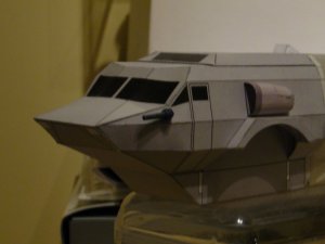

Curved the 'petals', recoloured and made the barrel tighter.
Just about there.
