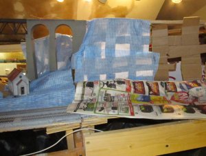

I have started plastering this stuff. I have three 100 bags of house plaster I had gotten for house repairs ( my house is a 130 year old farm house, and I have plaster lath walls. we are thinking of redoing the worst walls with sheetrock, so I thought I'd use some of the house plaster. ) the house plaster is way coarser than hydrocal, it does not carve well, but it does make a good solid base, that thinner layers of hydrocal can be put on top of for carving. Also in places that won't be carved it has a good gravely texture, which may require less ground cover to get a good looking surface.
I spread a big thick layer of the house plaster, over this, and let it dry. I then came back and dampened the house player with a spray bottle, and then slathered a thin layer of hydrocal over the house plaster. the next layer of hydrocal, I should be able to start carving rock formations, and that is where this gets really fun.
In the bottom photo note the newspaper. a trick Dr.Tom and I have been doing for ages is to spay both sides of a sheet of newspaper with some of the wet water from a scenery spray bottle, and then lay it on top of whatever you want to protect. the damp newspaper lays a lot flatter over uneven surfaces, and when you layer up three or so layers, there atre no gaps, and you get pretty nice protection of finished, or partially finished areas, like my log retaining wall.
This is going to be a lot of fun. next time I'm working up there, likely I'll be carving rock formations, and that is when things start to look good. It will be great to start to get that massive bridge anchored firmly on the mountain!
a45a 10-23-16 landforms #1a.jpg a45a 10-23-16 landforms #1b1a.jpg a45a 10-23-16 landforms #1cca.jpg A45a 10-23-16 wet  newspaper protection..jpg
