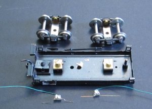

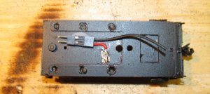

Ma & PA 2-8-0 tnder frame.jpg more progress
I got a hole drilled through the tender floor to allow me to pass wires from insulated pick ups on the tender trucks (not yet built). The pick ups will consist of small PC board tabs fastened to the tender trucks with JB quick, with wires and phosphor bronze pick ups soldered to them. The larger of the two center holes is for the wires, the other hole is for the screw that mounts the tender shell.
This locomotive is close to operational, It will need some more cosmetic work, a coal load, and some miscellaneous details, but I am getting close.

SML-A1Tndr pckups.jpg Tender wiring
My Ma & Pa 2-8-0 project has been stalled for a month or moor as I could not fine any of my stashes of super fine, flexible wire, which I needed to wire in some insulated pick ups for the tender trucks.
I was cleaning up my work bench area while my wife watched the football game, and I foud some super fine wire, so I finished manking the lectrical pick ups, so Unless I have built in another short, this locomotive will have pick up on all wheels except for the insulated pilot wheel, and one insulated driver.
Bill Nelson
The tender is together, no short, this locomotive is starting to look good, just needs some detailing. I have to get off my keester and get some decals put together, I have a lot of unmarked locomotives out there.

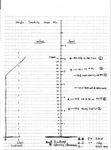

here is a planning document, a scale drawing showing altitudes only of the sub roadbed 's top surface at the four levels my new construction will have to splice into the remnants of my old railroad.
on the altitude chart, the notations with the stars are the four sub roadbed heights I have to match in an orderly fashion, and the rest are features of the room that will affect the design process.
Had I done an altitude study like this 28 years ago, I would have realized that cutting the headroom above Harlow to 18 inches from 24 inches would have greatly simplified the design process, and greatly reduced the ruling grade on the mountain division. I would not have been able to optimise my space though, as 28 years ago, I didn't know about helixes.

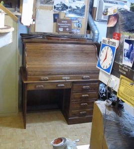

SMLA-1 dsp dsk #1.jpg SMLA-1 dsp dsk #2.jpg South Harlow Tower!
#1 son was heading back up to the University of Dayton for graduate school, so this morning was my last to get some extra muscle ; so I finished cleaning out my old hobby cabinet, and got him to help me move it down to the garage (I have to clear out a space for it, as my wife will want to get her speeding ticket red Miata back into the garage before bad weather returns)
Then I got him to help me move the disassembled roll top desk up into the RR room. It made the tight turn at the top of the stairs better than I thought it would, and I love it up there. I'm satisfied with the fit, and can now do some final planning around it.. I think I am committed, and I may start to remove condemned benchwork by the end of the month.
Sadly the desk was designed to be a computer desk, the drawers in the base conceal a roll out printer drawer, and the drawer under the desk top conceals a roll out keyboard shelf. The only computers I own that will fit it though, are as outdated as the 50 Cal. flintlock pistol on the desk now; a black and white Mac SE-30, and a tangerine Toilet seat Mac ( both old macs will boot, and the pistol will bullseye). The SE-30 might be useful if I could restore it's original operating system, and set up some operating tools in Hypercard. I'm hesitant to do that though, as it boots now, and all that old stuff is on floppies, and God alone knows if those will still work.
In the photo's you may notice the level of armament; this is necessary, as The Harlow South Tower is in a very rough neighborhood. Now I will have to build a south Harlow tower, I'm thinking there will have to be a North Harlow Tower as well , as the Harlow trackage will be shared with the Southern Railway, so I will have my first excuse to have two interlocking towers!.
#1 son got me a big round reproduction Southern railway metal sign for Christmas, a welcome addition. an original Southern Railway Station 1 Mile sign graces the door to my RR room. Brian Kremindahl, a high school buddy of mine rescued it from a junk pile and gave it to me back in the early 70's
