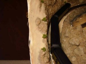

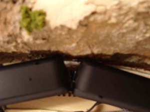

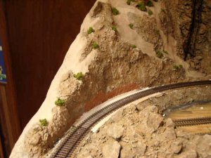

the colored area at the bottom of the cliff wall is sticking out too far and the passenger cars were hitting it and derailing...ouch!
I don't know what happened...I studied the prototype...measured twice and cut once...checked my givens and druthers...looked before I leaped...a bird in the hand is worth two in the bush...a fool and his money are soon parted......in short..........my dog ate it!

Steve, i too had this problem on dads layout:( , but was an easy fix!:thumb: the rockwork i put on his layout NEVER gave us problems, the largest engine at the time i put it up we ran was my 2 challengers, they cleared the rockwork NO PROBLEM:thumb: . THEN i got the Big Boy...PROBLEM, the Big Boy "JUST" hit the rockwork, barely, but still, it hit:( . LUCKILY, the section it was hitting had thick enough plaster on it to where i just shaved some off:thumb: , now, NO PROBLEM!:thumb::D. Steve, looking at your work, and knowing the drive you have, i think this will be an EASY fix for you:thumb:. announce1 BE AWARE OF THIS THOUGH; SOME CARS "ROCK", and at faster speeds, they may "rock" more!:eek: so when you fix the problem, don't make it so the car "JUST" clears, make sure you take enough out for "rocking" cars too;) . just my thoughtstooth1 . :D -Deano

I remember one layout where there was hidden track with cardboard walls. The car that rubbed against the walls was doodlebug (gas powered railcar). Not sure why that one.
Mark where the cars rub and take it back a quarter inch, then check again.

Why not Grab a NMRA gauge and use that when making your trackside rocks?
I did that but it didn't help with the nasty overhang caused by long cars and sharp curves.
Here's what kills me...I tested it with the freight cars even though I KNEW the passenger cars were longer. I just looked like there was plenty of room. DUUUUUUUUUUUUHHHHHH!
what was I thinking? Any way...no big deal and an easy fix.

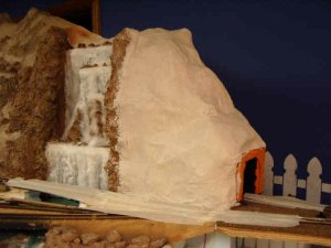

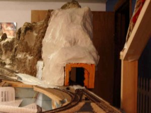

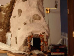

Here's all I got done tonight...the plastering on the portal. I need to sculptamold and paint it ect. I'll try to pick up the pace this weekend...we'll see

Steve: the NMRA gauge is good for straight track only.
I work clearances by taking my longest car and putting a pencil on the middle of the inner side and running it around the curves. Then again with the pencil in an outer corner. Repeat a few more times, looking for the widest car and the longest end overhang. Then try any oddballs like articulated locos.

Yeah...I found out the hard way!:D But I like your pencil method and will incorporate it next time...thank you:thumb:

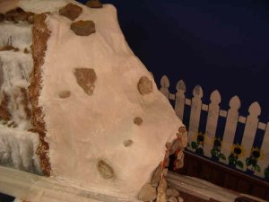

I glued some real rocks around the portal and a few on mountain....next step will be sculptamold...you know the drill:D

Steve, GLAD to hear your daughter won a RIBBON!!:thumb: as far as the TT goes, i could DEFIANTLY live with a turntable looking like the one in the link!:thumb: and i know you could pull that off;):D. one of the things i REALLY liked about your rock work, is that you use some real rocks in it, NICE TOUCH:thumb: , new undertaking looks GREAT so far!:thumb: :thumb: :D cant wait to see how it turns out;) :D -Deano
I really like the rockwork too. As for the TT in the link, I'm sure you could pull it off, and it would go well with what you have done so far. I don't know what the Walthers one looks like though

I know this is info too late BUT, what I do is make a clearance car. It is ugly and has only one purpose. To make sure everything will fit.
I make it as long as my longest car, wide as I need it and as high as needed. I then run this around too see if what I am doing will fit. I make sure it overhangs a lot, just like passenger cars do.
Anyhow, Like I said, it is ugly but it does one thing well and helps.
I hope that helps you Steve :D
