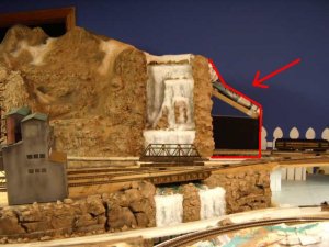

It's funny how completing or at least starting different phases of construction leads in totally different directions that those I had originally envisioned. As one "piece" is put in place, other possibilities present themselves and call for DECISIONS to be made. I guess I should have saw this coming (I did to a certain degree)...but I never thought the evolutionary aspect of layout building would be such a constant. But it is an extremely exciting and enjoyable part of this hobby. I also never thought it would be this intense, requiring learning all sorts of new things and problem solving on the fly, so to speak. Just an added bonus to The World's greatest Hobby.
Over the weekend I'm planning on finishing (except for paint) the tunnel portal on the right side of the upper waterfall. This will complete the construction on the upper left side of the layout. Sceniking still has a long way to go!
I will need to be making trees, doing ground cover and eventually turning my attention to the lower section and build a bridge and do the plaster and rock work to "finish" the entire left side.

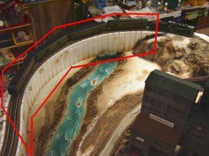

Looking at the second picture, down at that wide spot by the river...a great place for a mini-scene. Do you have one in mind? Well, of course I've got suggestions, thanks for asking! A hunter's cabin might be nice, or fishing scene.
And as for the bridge...lately I've been looking at some of the bridges and trestles around here. If you went with the steel girder approach then concrete piers all along there could be good especially if you want to allow a view beneath the bridge and up the river. But if you went the timber trestle approach, then perhaps a combination at the river crossing would work, with timber bents all along the left (in the second photo) leading up to the bridge with doubled bents supporting a girder section over the river. Any thoughts as to concrete or cribbing for the ends of the bridge section?

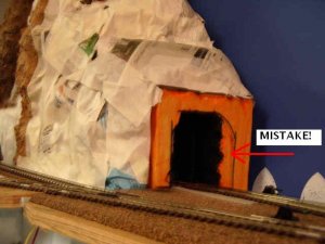

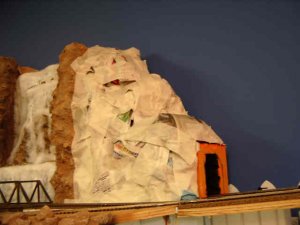

You know how sometimes, you plan things, and for some unknown reason...LIFE gets in the way...well it got in my way (a little bit) this weekend. I got the tunnel portal built but not plastered or sculptamolded (is that a word?).
Here's what I got done:
Not what I planned but better than nothing!

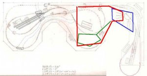

Now on a more important note....changes. This is what I'm thinking:
I'm not real happy with the turntable. "It seemed like a good idea at the time" But in reality it ain't working too well. You all know why....too much real estate, turntable too little, ect.
Here's a pic of the area:
A couple of ideas:
Get rid of turntable (blue)
Add industries there with connecting road to buildings in area marked (green)
Or turn entire area into two level town (red)
also note the loop at the bottom of the yard to turn trains
Or I could leave it as is.
Ideas?

I have been giving thought to a mini scene there and above the mine if I don't use the Campbell's mine as a dilapidated one. I was thinking grass and horses maybe wild. But I thought about fishing as well. Of course the ol' hobo's camp crossed my mind too!
Bridge....I want a girder bridge with steel supports and concrete piers....how long I make it, I don't know. That's really why I haven't scenicked anywhere near there yet. I could make it long...past the river and carve more of the blue foam for gorges and such.

I do kinda like the idea of adding the extra loop, to turn the trains around, for continuous running. I myself am not a fan of that turntable, and the area is too small for a NICE one. Seeing as how you have no roads as of yet, I'd say put put a Main St with a small downtown district there. Combo of red and green I think
OR,...you could just REWORK the trackplan, buy a couple UP AC4400's and a UP SD90/43MAC, and then just...tooth1 sign1 ...OH SETTLE DOWN FOLKS!, Steve knows I'm just kidding;)sign1 **ON a serious note, Hmm...being a certified(certifiable reallytooth1 )engine nut;) , i am a little concerned about loosing engine holding tracks. if the turntable isn't working out for you, how about a couple straight engine holding tracks? just a thought:thumb: .:D -Deano
Yup that sounds like the best idea.....You dont have to have a turntable to have a nice Engine house and some fueling tracks.
On a side note Im kinda glad you are taken that Atlas turntable out....It wouldnt look right with the rest of your layout....You have done a GREAT job and to throw that thing in would be a shame.
Maybe the Walthers Trasfer table? I just seen one on EBAY
Where were you 8 months ago when I needed you!sign1
-Deano
point well taken:thumb:
I like the feed back........more please:D :wave:

Steve, you’re doing a fabulous job. I really admire your mountains and rocks :thumb: .
I think Deano had a very good idea about the straight engine storage tracks (or a small engine service facility?) instead of the turntable. When I started to build my switching layout, I only had two enigines and thought that I wouldn’t need any more locos to operate it, so no need for engine storage tracks. HA! How wrong can you be? :curse: Engines are addictive. I have seven engines now and my collection is still growing, slowly but constantly. And it would be nice to have some place on my layout to display them. The good thing about it – the lack of engine storage tracks gives me a good reason to plan a new layout :D .
Engine Service Facility
Steve:
Run with what Dean-o said about storage for engines. How many do you have now? You could get some Walthers kits for engine servicing, add a few tracks, maybe a RIP track, and be off and running. I think that would be another good chance to do some great modeling.

Wow, that makes 9 engines and only 20 cars. So. . . . get some engine storage.
For a steam nut like me, a turntable is too much fun to get rid of.
That said, without going back through 22 pages, are you running diesels or steam? If stinky diesels (:) ), the others' suggestions are right on target.
But if you are running steam like a good railroad should (:) ), is your Atlas turntable the older or newer version? The newer version allows closer spacing of tracks - 15 degree separation instead of 30. Another suggestion would be to only use 2 storage tracks that are curved to be parallel and go into an engine house, not a roundhouse. The best way to avoid eating a lot of space with a turntable is to have all tracks coming to/going from the turntable on one side. Last, if the Atlas turntable is too short for your steamers, it can be used as a base for a bigger bridge. Some links to modifying the Atlas turntables are http://www.2guyzandsumtrains.com/Content/pa=showpage/pid=11.html and http://pages.sbcglobal.net/sgratke/sgrr/trains/matt/index.htm. Or the Walters 90ft and 130ft turntables are somewhat and much bigger (about 12" and 18").
my thoughts, your choices
I think he is running steam. That being said why not get the Walthers Turntable and install that back in that turn around you are planning on putting in on the far right bottom corner?
