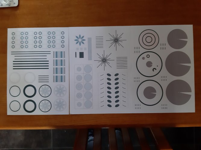

It was a bit of work but I can begin with building the first parts. I will start with the yelow marked area.
And here are the first templates so lets start building.
Thanks for all your tube sugestions. I'm gone build them with paper so fingers crossed.
