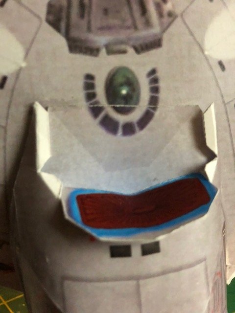

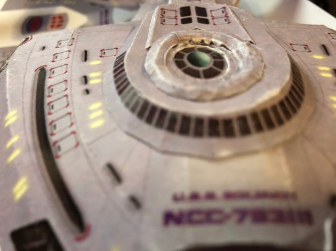

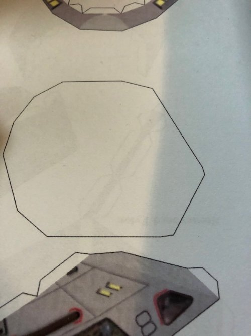

This second image shows how the hulls do not join well. It looks like, if the glue tabs drop under this joining flap, then the hulls would be flush; they are not. Putting the flap under the joint base raises it to create an awkward over-flap. If the joining upper hull flap is dropped below the lower hull "prongs", which is the way is is supped to fit per the images, then theres an un-used glue tab left, and even if this is cut off and unused, a lot of white space left evident around the navigational deflector (the blue-gold thing that glows in the show).
Reactions: Revell-Fan

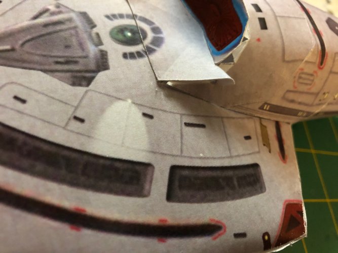

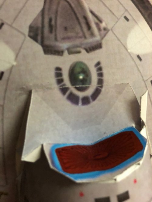

The last pic illustrates the problem. It shows how, if the tab is under the "fork", it doesn't join well; if above the fork, not creates a gap. Either way the fit is
problematic.
I have attached second-same pic with labeling.
Any guess how this is supposed to fit?
I have largely finished the rough build of the Clever kit, but have been stopped at this juncture for the StarFreak Warpgondeln kit, by this fit problem
I think there was an intersection on the CG model which was overlooked or the pointy edge of the saucer piece is in fact a double face from the lower hull part. I would glue the parts in place where they definitely fit. Then cut off the problematic area and make a new piece which closes the gap and joins the parts perfectly.
That is a good observation. It might have been the way to go.
unfortunately I saw this message too late!
I tried forcing the fit in alignment with the pieces detail. It came together but warped a bit, and the "prongs don't create the shape that should be expected. There is no inner part to avoid white-spacing.

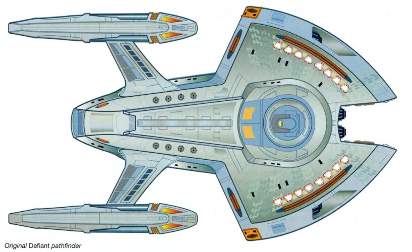

The Nova class Equinox history
Okay; so some background upon the target of these two models, before discussing the two kits in more detail.
The Nova class vessel could have had on its dedication plaque "The little ship that could..." or even "A design before it’s time!"
The background of the fictional ship came from the third season of Deep Space Nine. During the beginning of that season, there was a plan to give the writers more freedom for storylines by adding a small starship. The use of then runabouts was found to have limitations; the short-ranged craft were too small to compete with many of the standard models used in the series, and the station rotation wasn’t permitting boldly going, as much as it resulted in bodily waiting…
The history of the planning is fascinating (there were unresolved arguments over how big the ship would be permitted to be that even impacted seasons of unresolved certainty for years after!). The debates extended to even the changing of the ship’s name from Valiant to Defiant; because the producers were concerned with the audience getting confused, if two parallel-running Trek series both had a ship with the letter "V" (Voyager was running at the same time). Cooperation between Star Trek production teams has been notoriously strained and the Defiant found itself at the behest of competing interests of the Voyager staff and the Next Gen movie staff.
Rick Sternbach, who had a long pedigree with Star Trek, by that point of the history, designed a ship more in line with traditional Star Trek in-universe lore. The vessel had similar lines of Starfleet vessels, with extended warp nacelles, atop spanning pylons. The "Pathfinder Project" was the dubbed response by Starfleet to counter the Borg threat; designing small, adaptable, extremely fast vessels to counter any invading Borg cubes. These vessels would have s strong torpedo spreads, a wide range of phaser strips (that permitted frequency changes in the power [eh? Multi-frequency particle-phased energy?]). Sternbach introduced the design as a combat vessel with several interesting characteristics; two, upswept nacelles (similar to the Sovereign class design), what would later be used as a Defiant, inset-bridge, eight deflector crystals (signifying overlapping shielding systems; later used on the Defiant), and a series of heavy photon torpedo bays, set up in the sides and in the notching the front, arrow-shaped hull.
The design was rejected.
The producers decided to go with a more radical design with enclosed nacelles and a non-traditional formation (the issues of nacelle radiation proximity to the operational-hull [never explained], nor the ability of the nacelles too stabilize a warp field by having a line-of-site magnetomic flux chillers). Sternbach liked his design and shelved it for potential future use. He’d put a lot of thought and care in it and wanted to find a home for it in Star Trek canon.
The possibility resolved with the publication of the Star Trek Next generation Technical Manual. The semi-canon book [don’t ask me to clarify semi-canon in the age of Bad Robot…] explored the Borg response and Sternbach provided it, with some help from Dough Drexler, as a planned response-ship.
Years later, Star Trek Voyager was facing a season five cliff-hanger tale, that would involve a new ship, also stranded out in the Delta Quadrant, with a crew that had committed wrongs to save themselves. Season finales often involved cliff-hangers and an opportunity to pull out all the stops to draw in viewer, not only for the cliff-hanger, but for the next season.
A science ship, the Equinox, was scripted as the sister ship that Voyager was planned to confront. Sternbach pulled out his old, shelved, Pathfinder Defiant plans [by the way, Pathfinder, as a term, was later used in Voyager too, for a different storyline]. His logic was that the Starfleet admirals may have passed over the design for the Defiant-Pathfinder Project, but would use the ship as a replacement for the ageing Oberth class science ships [given the onscreen performance of the Oberth, this seems pretty reasonable…].
As a science ship, the design didn't need to be as weaponised as the original use would justify. Modifications to the plans were made; the bridge was made more traditional, the multiple deflector crystals dropped, the multi-torpedo bays swapped out for sensor pallets (two single torpedo bays were placed at the very bow of the design), and the engine pylons raised a bit. The vessel didn't have an impulse engine set-up in the original plans; this was fixed by adding one near the aft of the forward-upper-hull section. The rather unusual, multi-deck, Muti-door-access shuttle bay was retained (more about this, when I discuss the model kits, as it become a significant detail to the designs). The forward-notch pair of torpedo tubes were removed and a secondary deflector was added in that place.
The result was a very popular design, surprising, given how little screen time that it enjoyed. The Nova Class Equinox became a soon-sought paper model...
[next; the kits]

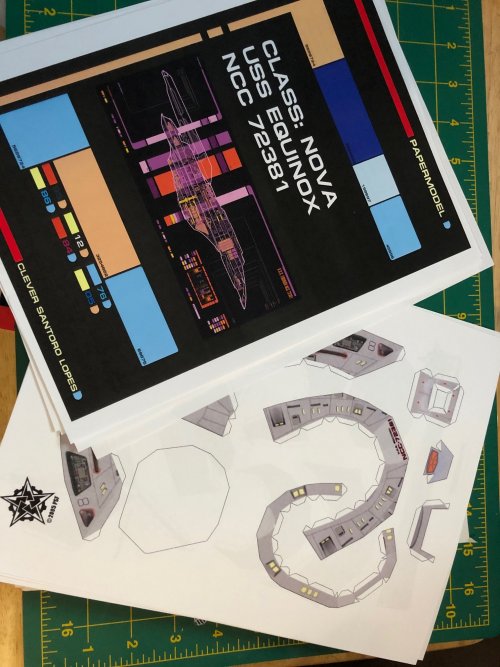

The Clever Kit
Clever Santos Equinox kit is very attractive and detailed. It looks like a professional package [see pic 1]. Even if you do not ever build this kit, the version is worth downloading and examining, as will be explained below. Clever did a very nice job of packaging the kit and making it interesting.
It contains glue tabs for most of its parts, and has very slight fold-lines for shaping the hull. The fold lines are so carefully included that they can "disappear" after the build, when examining the finished product.

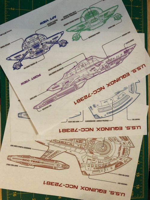

The first page is a very colourful cut-away of the Equinox, which is worth examining. The cut-way will provide discussion later on, in the building of the kit, regarding the unusual shuttlebay set up. A second page provides contact and legal detail regarding copyright [see pic 2].
The next section consists of 5 pages of parts. Four pages are coloured, detailed parts, the last a selection of framing pieces, with a diagram of the construction of the skeleton [see pic 3]. The diagram is not very clear, when it comes to constructing the frame. This is a shame and a lost opportunity. The diagram illustrates two flat pieces, assembled in parallel, with several half-sphere connection the pieces, all to provide structural framing. A good idea, in theory, was not clarified with adequate instructions and adequate pieces. The two flat pieces do not appear to match the size of length of the diagram’s elongated frames bases, and the 7 half-spheres do not seem to match the size and placement for the provided diagram. Framing this model is important, as will be explained in later sections, and the diagram, were it to include written description, or at least numbered parts with placement indication, would have made the kit more valuable to a builder who didn't have the pdo to explore and figure out.

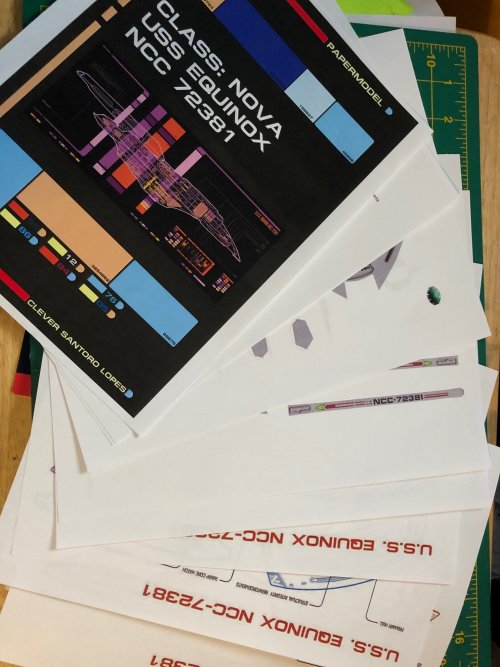

The last section includes three pages of colourful diagrams of the ship [see pic 4]. These are worth the kit alone. They not only detail the exterior, but they also share in-universe detail of the components. The three pages are not without error, however. The impulse engines, on the multi-design ( 3-view) page, are labeled the Aft-Ventral bay [the upper ventral bay doors are actually the small doors below the inaccurately, designated part], the hull-cargo access panels are mislabeled impulse engines, the ventral phaser strip is mislabeled a tractor beam emitter, the magnatomic flux-chiller is mislabeled a warp field grill [slang?], and the designation of a primary/secondary hull is made, when this ship does not separated (so there's really only one hull). That last point is picky, but the labelling would more accurately indicate upper/forward hull and lower/aft hull, since there is no separation of the sections, even for any emergency separation [at least as described by Sternbach].
The kit does not have instructions; a real detriment to the utility of the product. Some of the fitting, curving of the paper, and placement of pieces is specific and would benefit from guidance, by the author who knows how the two-dimensional parts fit best for the final three dimensional goal.
Still, the kit is colourful, appears detailed, and is attractive. Its a very promising kit, leading to a test build to seek potential goals of garnering this attractive little eight-deck ship.
My critique of the kit is not an attempt to offend the author, as the start is promising and the kit attractive. I was trying to build it to provide a build thread and maybe instructions. The need for build-instructions is important for early builders, as well and more advanced builders, who like building but are less enamoured by working puzzles. My respect to Clever Santos and I am willing to work with him to develop instructions, as I believe this kit has high potential.

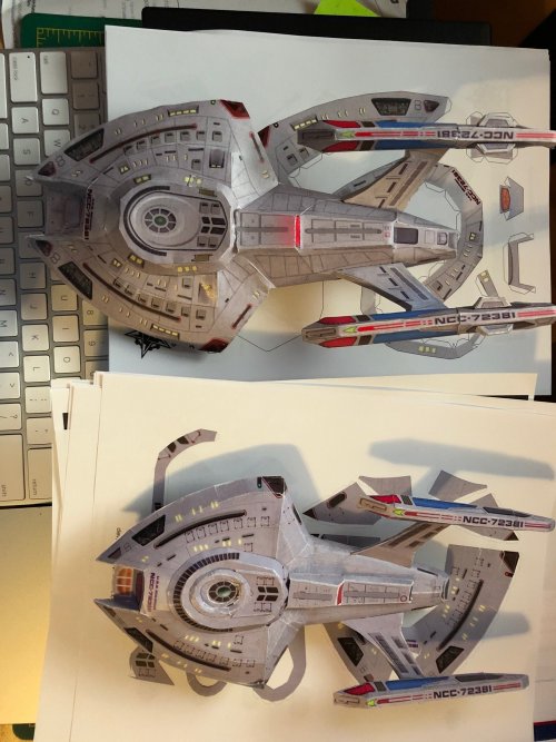

Below is a pic of the two rough builds. I shared this, despite the poor workmanship, because I was requested, and I hope that it will encourage critique and discussion. I didn't do any edging, adjusted colouring, or other effort. I wanted to see how well the kit shaped and if I needed to build the quality build in a certain way, and whether framing or build adjustments would be necessary. I find the practice informative.
I also wanted to show how different the two kits were in final size (PSF on the left, Clever build on the right). I hope that the comparison helps guide your decision on which to build.
Personally, the PSF kit was a nicer size for me. If I had Spaceagent's skill, the larger size would also promote better lighting potential.
Were anyone to make an effort to Frankenstein the two kits, or to borrow parts back and forth for a final build, a consistent sizing would have to be determined before printing out the sheets, and one, or both, adjusted for the parts to be sizeable to the other kit.

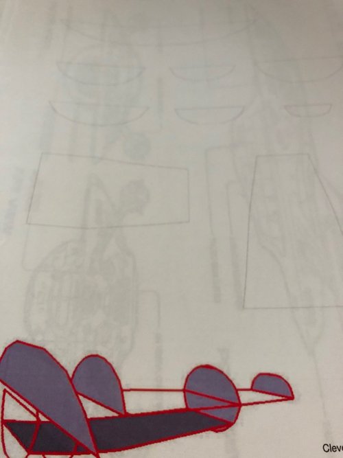

Comparing the two kits, after the rough builds, suggests a real need for internal framing. In both kits, the shape distorts as the glue cures and pieces start drying and tugging against each other.
The PSF kit has one framing piece, shown in pic 2. There are no directions, but I think it is intended to have been a connector framing piece between the upper and lower hulls; a joining plate., That seemed to have been the best fit for this framing piece. The PSF kit needed more framing, especially in the upper/forward hull. The arrow-head hull part suffers from sag and bulging, which framing would counter. Framing for the lower, engineering hull would have helped in construction, as well as in maintain g the shape. The folding of the PSF hull pieces can get a bit hairy without the guiding frame. The shaping of the pieces to make this hull is genius! Its just a challenge to fold them into cooperative shapes.
The Clever kit included a full page of framing parts [see pic 1]. There is a diagram of what configuration that these frames are supposed to take (see lower page, in red/gray diagram). Unfortunately the diagram is not helpful enough. More description-explanation was needed. It took a bit of metering (and a few choice words) to get the frame together, and some parts just don't permit what is represented in the diagram. The parts do not configure to the pieces available, leading me to wonder whether the frame page was intended to be reprinted several times to create the shape, from multiple or spliced parts? I just don't really know. A more skilled builder than I was needed to figure this out. The horizontal frames are not the size shown in the diagram, with at least one warped-rectangle too short to create the diagramed effect. Which is the upper and which is the lower is unclear. The semi-circular framing pieces also are not clearly delineated. The large semi-circle somehow goes into the upper/command hull, and the smallest probable fits into the stern of the lower hull, but the rest of the pieces are not delineated as to placement. Somehow, the rectangular section at the bottom (whichever that is) goes through a couple of semi-circles?
Not sure. I never figured it all out. Every configuration I tried was incompatible with the hull built later.
Communication is an essential aspect of human relations. An author, in a text, must use language to convey ideas. Mastery of language and descriptive capacity are the foundation of the written work.
Authors of paper model kits would further the value of their efforts by providing such descriptive guidance. I was looking over a few kits that Ninjatoes and Paper Aviation provided; each had diagrams or text instructions. These help.
In any case, more framing than either kit provides is needed for a quality build. Clever's kit does have more framing than the PSF; you just have to mind-wrestle what he planned with those shapes.
Whichever kit is chosen, consider as you test fit pieces, how to add more supportive framing than either kit provides; both to guide your build and to support the shape and the pieces tug against each other.

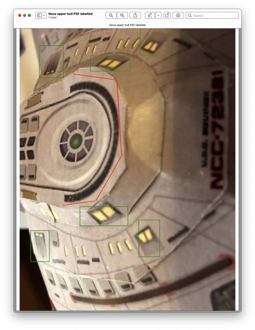

AN important note for detail oriented Trekkers. I had to play with these images to get them to load!!!
The Clever model has a serious error in the printing that the PSF model got right. Look at the Clever model, pic 1, where the red lines suggest the sensor pallet along the front of the command hull. This is not where it should be (see online images of the digital model). The PSF kit gets it right, as seen in pic 2, where the upper sensor-band is placed atop the command hull.
Another advantage of the PSF model is the window accuracy. The Voyager and Nova models had inset windows along the upper/command hull. If you look at the Clever kit again [pic 1], you may note several blank places next to the slit-windows. This blank space was supposed to be the place where inset windows had been placed in the Digi-model.
In pic 2, the PSF kit has several green boxes that draw attention to the missing inset windows; those missing from the Clever kit. This is a big detail, making the PSF kit a bit more attractive to a detail-builder. The printing of the inset-windows is well done, forcing perspective of the detail, and if a builder were so-motivated, they could provide a builder with the means to alter the printed windows into the basis for 3D scratch-builds. This is what I planned, if I could get the rest of the build figured out!
The last note on this section involves the hull portion just behind the bridge. There is a pair of sensor pallets flanked by two lifeboats on either side, on both kits. The big difference is that the section is a single flat, painted section on the PSF version, where the Clever kit has a separate part that raises that sensor-lifeboat section. I like the idea of raising this, but the Clever version's appears unfinished, as it doesn't have connective trim along the edges, resulting in an awkward fit. The PSF version, though its ink-dependent, makes for a better finish. The Clever version just doesn't provide a clean fit for this piece.
One last, but worth noting difference between these kits, is that the PSF uses colouring effectively to suggest the beacon lights from the command section of the hill to the name below. It's a nice detail.

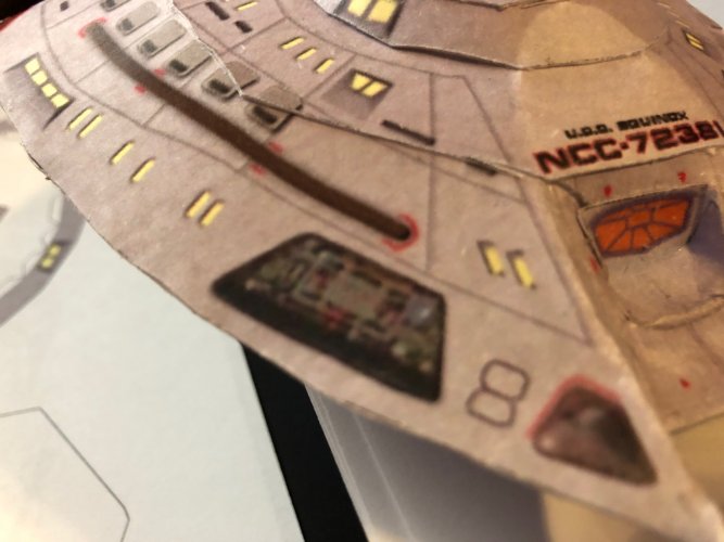

One last bit of difference to share with you tonight...
Along the edges of the upper hull, the Digi-model had inset sensor pallets that were composed of dark areas with tiny accent lights of several colours.
The PSF model represents these well (compare PSF pic 1 with Clever pic 2).
And in front of the señor pallet, there was an opening for two torpedo launchers. The launcher is detailed on the PSF kit, but is a gray shape, without detail, on the Clever portion.
In these rounds, the PSF kit seems a better choice.

I have found, when I do use tabs, that it helps to "indent" them, after cutting them from the page, an indention-space the measure of the paper, creating the "shelving" effect that plastic models provide with those plastic tabs. This is especially helpful when forming a sphere (like on a Dadelus class) as sphere can easily miss-shape during a forming effort. That's a bit tricky, but it helps with a flush build.
Again, in this case I was test-building a rough experiment. I did learn how and where to bend and curve from this first effort, which I didn't know before I tried. It was a bit of puzzle building and trial and error just to complete the rough-build! I try not to focus much on the quality of appearance during the rough build, as I am intending to try to figure out what the author was planning with the pieces that he printed.
I am not sure that these kits can be salvaged, but I figure that possibility is most possible by combining them. As I continue comparing the two, this assertion might be more clear, as there are benefits and weakness's of each. Some positive of one might help modify the weakness of the other.
I'll ask your advise one I get this analysis complete.
I hope it's helpful to you prospective builders. Like you, Zathros, I did like the design of this ship!!!
