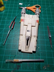

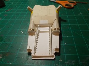

DSCN0558.JPGDSCN0559.JPGDSCN0560.JPGDSCN0562.JPGDSCN0563.JPGDSCN0564.JPGDSCN0565.JPGDSCN0566.JPG

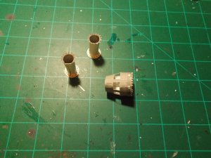

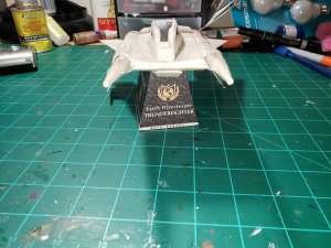

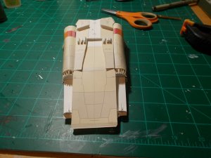

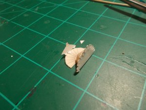

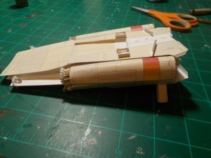

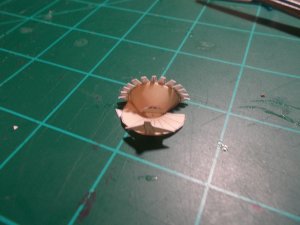

the current state of the build, top and bottom halves glued together, starting on the skin, now starting on the engine bells... my fingers are too big for this even at this scale. i have reduced the planes to 95 percent using paint, i downloaded the free version of gimp, but can't make heads or tails of it...

Looks good Micah, not an easy model to build. I'm sure you've figured out. ;)

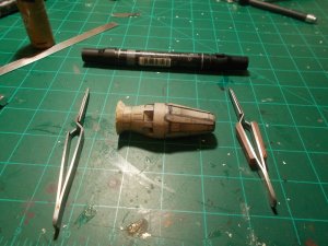

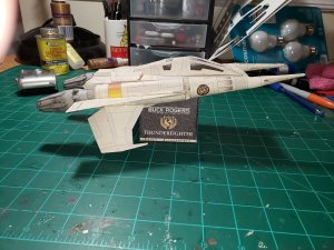

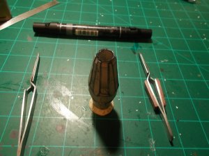

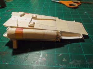

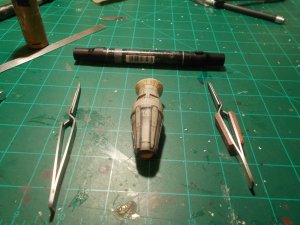

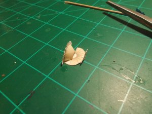

one engine tube finished, my edge color marker that looked good on the sheet is too dark on the kit... oh well. my small self closing tweezers, both straight and bent, and my prismacolor marker, i only have 3 that still work, from my days as a draftsman 30 plus years ago...

It looks good!

I think it looks great. Especially this being your first one like this. This isn't an easy model. If you built one without shrinking it, combined with the knowledge you gained, you'll make one even better. That being said, this one look really good. :)

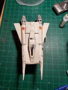

Thanks "Z" It's a learning curve again, with this model the parts that were doubled, left and right, the first one I did shows the flaws. and the second one looks better. I am re learning skills that I haven't used in a long time, and learning what my hands will let me do now.

Hey, that does not look too bad, really! You are right, the next TF will be much better now that you have familiarized yourself with the parts and assembly. Don't give up, please. This is a very challenging model and mastering it will bring your skills to another level. :)
