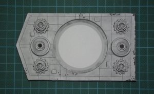

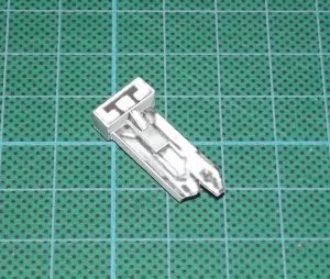

While looking at the templates and the original model I noticed some problems. The alpha test revealed a few glitches in the design which in theory was supposed to be OK but which in reality proved weird. The middle wheel of the Moerser Karl piece was sitting too low; in addition, it was extremely difficult to align the two parts. I corrected this. Now both pieces have been joined into one part which is much easier to handle.

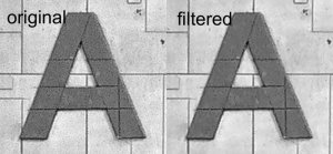

The results of the G'MIC filter are gorgeous! I definitely recommend this plugin. I have it run twice over the templates and the results are like night and day. The noise has almost completely vanished. I could have run it a third time but I didn't want to risk anything (the original source shall be recognizable).

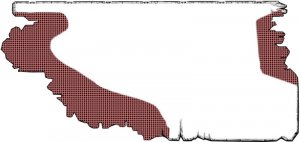

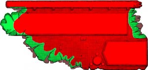

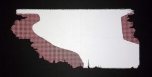

I changed the texture of the base layer and added much more of the grid pattern.
The reason for this is obvious: Now the layer containing the outer hull of the ship doesn't need to be laminated to the background completely. The outer rim is "floating" above the base layer and can be manipulated to create an additional 3D-effect.
The red areas are glued to corrugated card which then is attached to the base layer, the green areas remain unattached and can be shaped, deformed, rolled up or down according to your needs. That way you are able to look behind the outer hull and see the grid underneath. This gives a very nice effect, especially when you walk around the plate. :)

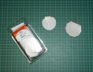

FYI: The build will be finished this weekend! All major plates have been attached and the pattern of the damaged clamp is ready for testing (the final part). I'm concentrating on getting everything done; the letters and the small plates still have to be laminated and the hangers attached. I'll post some pics asap, so please stay tuned! :)

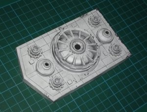

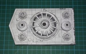

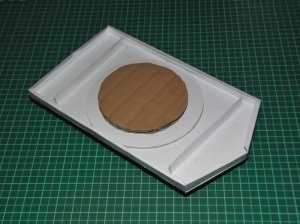

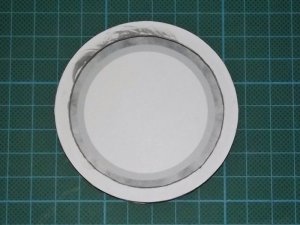

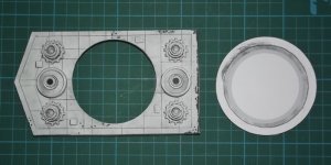

OK folks, time to fasten your seatbelts! Finally I have got some time to post the final pics of the build..! ;)

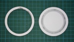

First of all I fixed an error in the design of the Moerser Karl piece.
The inner ring was carefully cut off and replaced with a new ring laminated to 2 mm cardboard.
This is glued to a new back piece.
New backing attached to the main part.
And center wheel attached.
The new construction ensures that the big wheel doesn't sit too deep and it is centered.
Some flat stripes will be added to the rim later. I used some cardboard pieces to the back (mainly to get rid of left-over pieces but they will serve as additional formers now ;) ).

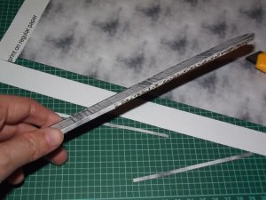

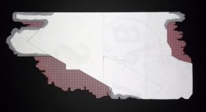

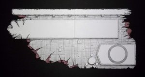

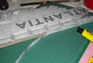

The single plates were laminated to corrugated card. To cover up the rim I prepared a sheet with a random cloud pattern which is printed on regular 80 gsm paper. This sheet is supposed to be cut to small strips which then are glued to the rim(s).
Please note that not all rims are covered with these strips. The areas which are supposed to look scorched and melted are painted with water colours. The corrugated structure will show at these areas and give the illusion of a layered hull piece. Water colours are also used to blend the end parts of the strips and the corrugated card.
Now the stacking may begin. Base plate with the grid pattern:
Corrugated card:
Steel layer:
Name plate, top piece and clamps:

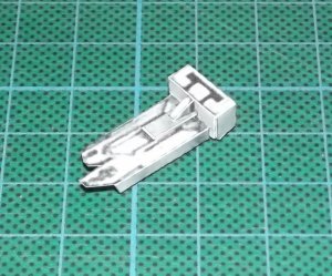

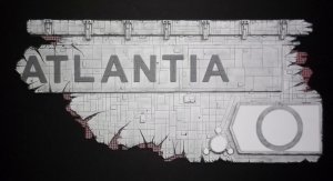

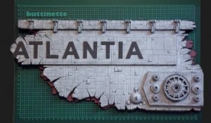

The broken clamp:

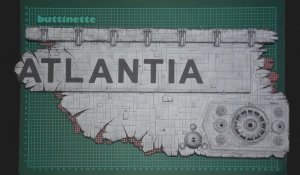

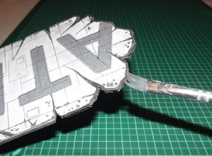

The rim of the whole plate is covered with anpthers trip from the pattern sheet and touched up with water colours:

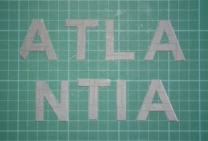

The laminated letters are attached:
... and lots of lots of LOTS of small plates attached to the surface..! :skull:skull:skull
