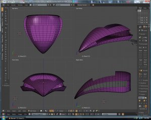

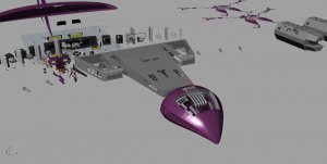

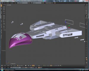

UPDATE:
Been working ...actually learning some new tricks and software with Zathros help..so that this thing will be better than just acceptable. In the meantime still working on the original mesh as everything is interchangeable...after many different tries, decided to basically do a rebuild of the Vorchan Head mesh, it looked good, but would never go to the general paper modeler. Not to many folks out there would be willing to cut segments that resembled cat whiskers and try to fold and bend them and try to glue them into a solid! So re-designed the whole thing and eliminated most of the small stuff, while trying to keep the over all feeling of the original...also eliminated the undulating insert along the side..for same reason... this now gives more options to add the detail of the side inserts..either a single sheet folded and glued in or a sheet glued to the back and U-shaped sections added to it...?? will see...lots still depend as not even thought as yet on attachment to main hull....
Same problem with horizontal and vertical wings... for some reason all the cut and folds tend to be on one side of each wing..when it should be equal.../ mirrored...so may have to do as I have with the head..and cut in half..fix one side /copy/past/mirror...and see it it works better!
here is a pix of the refined/simplified mesh of the Vorchan...

UPDATE: 1st test fit of rework and rest of mesh...LOOKS GOOD...or at least there is not things all out of alignment! or missing!..Get all the hard stuff out of the way...and we should be moving right along...maybe by Christmas...of course I am not going to say what year as yet! ;) Having trouble getting pix to upload so will edit one of head and joining bits together when I can...

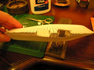

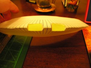

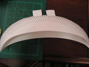

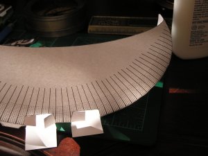

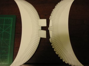

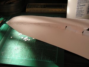

Test build main wing.
Here's the main wing (i.e. pita pocket):
One of the wings have tabs and the other side does not. Also, tried to experiment with forming the engines from the existing cardstock around the engine areas (see below). I don't think that it worked too well and recommend that separate engine constructions be made by inserting from the front to the back. This would give a more round shape to the back.
In constructing the wing, you start by gluing the center tab of the tabbed wing to the non tab wing
Next, you glue the tabs from one side of the wing working form the center to the outer most portion of the wing.
Reate what you did above to the other side. Back side of the wing. Note the tabs at the back.

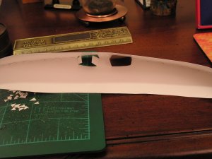

Top view. Both sides joined together. Recommend making dashed line marks at the front for placement of the front struts, engine nacelles (on either side of the top vertical stabilizer), as well as lines for the top and bottom vertical stabilizers.
Inside view joined together. Note the inside tabs.
1st left engine joined.
Engines have been colored in with a highlighter. The side portions form triangular pieces instead of rounded more oval shaped sides on either sides of the engines.
That's it for now.

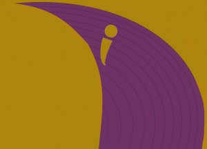

Gandolf,
While watching the DVDs your interpretation of this is spot on! The gold side sections on the sides are flat and recessed while joined to the flat horizontal sides - like you've done. Great job!

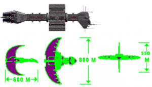

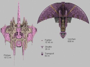

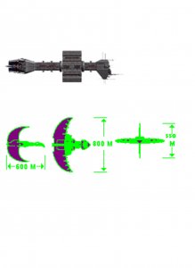

For those that are curious:
Here's an image of various Centauri ships to scale.
I think that the scale of the Primus to the Vorchan is a bit out of whack and should be revised. In the show it dwarfed the Vorchan.
Additionally, I was checking the scale of the Vorchan to the Omega Destroyer.
After checking the wing construction with the information above, Gandolf's wing design is comparable to Jaybat's Omega Destroyer. Of course if one tried to build a Primus to scale, that would be a BIG ship.
That's it for now.

Exploded Vorchan ... Junkyard tearing everything apart and seeing what can be used and what needs to go and what needs to be re-worked for paper! ( There are a TON of bits in this thing!!)...and it is like floating around in space searching ! Looking at this...3 years may not be enough time...
2 splayed turkey's in r-rear are 1'st test flat od Vorchan head without reworking, just as you see here..since..I have re vamped it and cut it into 12 pieces...that should flatten ..Way better!!
to be continued....

vorchan-verticalwing_col2.jpg vorchan-horizontalwing_col.jpg GenHull_Diff.jpg
last is a general hull plate texture and then the colored ones transparent over....
for the rest..just one piece at a time ...then from the inside out....
lots of cutting and re-working...and calculations to do...as each part is a complete ( box?) fitted into another, and they need to be cut / fitted to be buildable in the real world!! ackk !!
