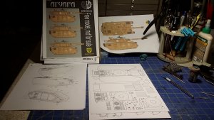

So, the BMP build is what got me started here and into hardcore paper model buildin in the first place. Sitting, since that time, has been the instructions and the file for printing off these Abrams inspired vehicles.
To my knowledge, other than the real world inspiration and some 40k ish general design items, this is an original design on the part of Patoroch. Frankly, these are the designs that are the best to me as they are inspired by post WW2 vehicles and more match my own sensibilites about what a good solid tank or other AFV should be like in the future (regressed, because, well, grimdark...). I'm hoping to turn this (and maybe a couple more) into the center piece of my slowly expanding Imperial Guard mechanized (possibly armored) regiment.

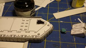

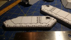

Just some quick updates on my box building and greebling!

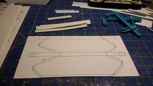

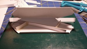

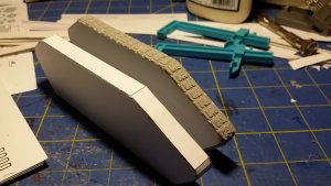

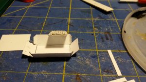

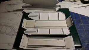

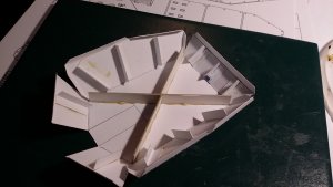

For my tread sections, I stuck to just thicker card strips cut the width of the boxes and run in an "X" pattern, which I again used on the turret roof combined with the bent angles:

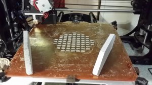

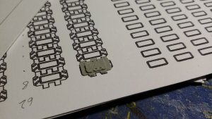

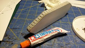

After assembling the boxe for the treads, I 3D printed individual tread secions and ran them along one of the boxes:
They came out rough, not being one of my better models... So I used some putty to make up some of those shortfalls.

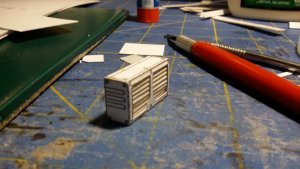

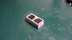

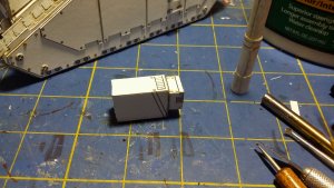

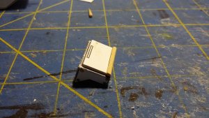

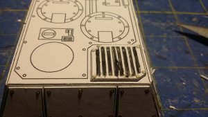

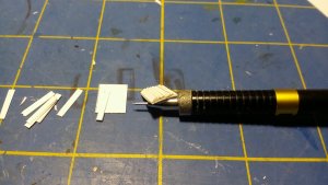

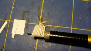

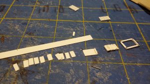

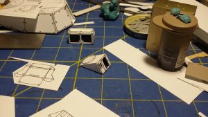

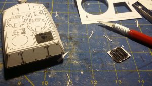

Finally, I decided to cut out the vents and make them a little more three dimensional with some paper strips:
Then I had to kick myself for not giving that exhaust vent a nice coat of black ink or paint before gluing it into that box! Ink it shall be when I get to it later! Primer spray and my paint brush are going to have some trouble getting at those edges later if I leave it alone until the end!

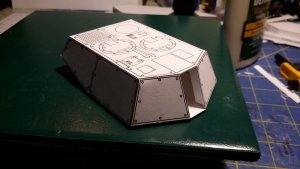

Monday madness building tonight!

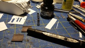

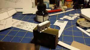

First, fixed my issue of missing the black ink on those rear engine vents:
Black ink liberally applied with a cheap camel hair brush from the hardware store!

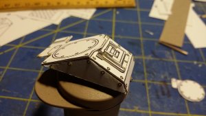

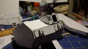

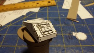

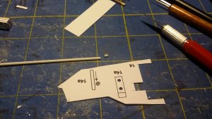

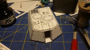

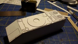

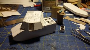

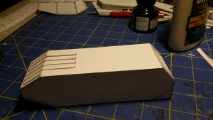

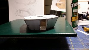

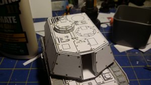

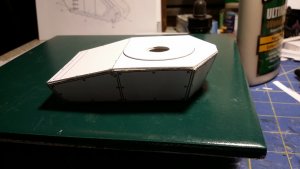

Got the initial box of the turret built with the ring on the bottom:
I also began the process of laminiating my first hull greeblies:
First of many flat layers. This will be followed up by glue dot rivets prior to laying down the next flat layer, which will again be followed by glue dot rivets and the next layer... until it is completed.
Bottom is completed.
As I'm building this, I'm starting to realize just how much this is going to require being in sub-assemblies. Those tracks are going to be one of the last things I put on this model just to ensure I get them primed and intial painting done with the amount of detail this main hull is going to end up packing in!

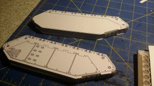

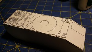

Just continuing with the process outlined yesterday on the hull, adding rivets to the base layer and first laminated layers:

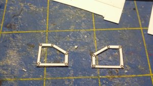

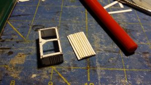

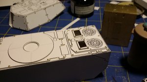

I also added some stiffeners to the engine exhaust vents:
Since I made some fancy vents with strips of paper for this, I'm going to do so for the rest of the model. By my count, that is four more vents. We have the two on the top of the hull we can see in front of the round turbine parts (well, I think they are turbine intakes...), and then two more on each side of the treads toward the rear. It'll be a lot of work, but well worth it in the end I think.
Not pictured is the second successful batch of 3d printed tread links. Took about four trys to get them right. I ended up re-slicing the models because my first printed layer was way too thin (0.05mm) so I bumped it up to 0.1mm for that first layer. Worked like a charm! I have learned to print more than I need though as errors crop up, and this print lost a couple of links due to such errors.

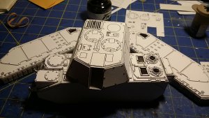

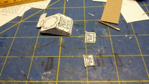

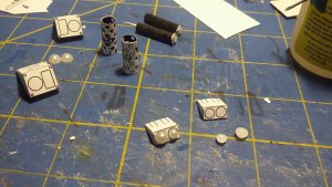

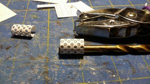

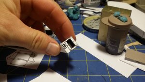

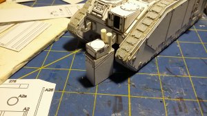

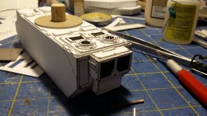

Last night I worked on some smaller greeblies.
I started with the upper hull vents like I did the rear exhaust vents. These might be more correctly intakes... But then, that is why it's "greebly" and not given names in most cases!

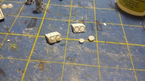

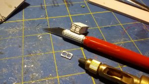

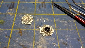

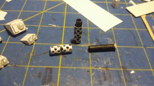

I also worked on the round turbine looking greeblies:
I added a half sphere bead to the middle because it looks closer to those hubs you see on these kinds of turbine fan blades toward the front.

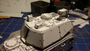

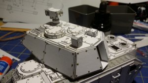

Finally, I finished up the side armor of the turret:
Happy greebling!

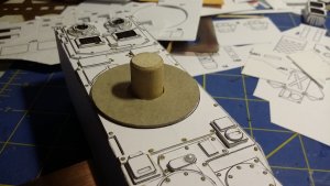

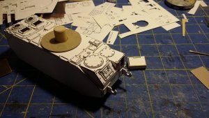

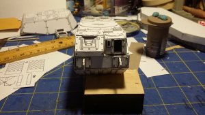

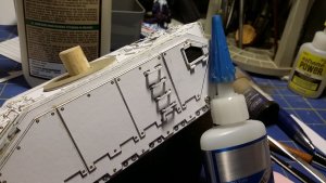

Slowly but surely, the front details are finishing up and coming together. Rear details are close to being mounted as well. Next major front assembly will the be the bolter, and for the rear, the exhaust stacks. I'm certainly looking at deviating from the pattern on the rear exhaust stacks based on prior experience and my desire to ensure they appear to be perforated shielding around the exhaust pipe... More on that later.
I raised the turret ring another layer (chipboard in this case) and added a wood dowel (1/2" or 12.7mm ish) for strength.

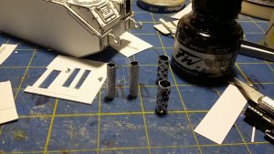

I started off finishing the hull with the rear vents glued into place. While I finished the exhaust stacks with shield, I'm going to paint those seperate and then glue them to the hull during final assembly. I changed how I did the exhaust pipe full length and having the shield around it like we would see on the real thing. That ivolved measuring the small strips to get the width, then measuring that height combined with the shield height. So, they are about 22mm wide by 23mm tall before rolling. After rolling, I gave the exhaust pipe a coat of black ink and glued them to the round base (part 12 and 12a). I also coated the inside of the shield with black ink. For the head and tail lights, I selected appropriate sized half sphere beads and CA glued them to the card stock. I've set these to side to prime and paint as sub assemblies as well.

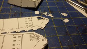

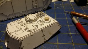

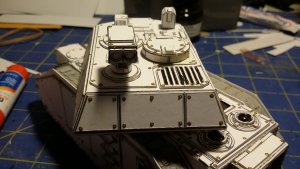

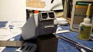

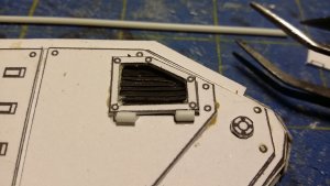

Nothing overly astounding as far as major progress tonight. Mostly just finer details that mostly involved laminating layers of armor on the skirt armor and creating the vents for the sides. I added the turret roof plate and started greebling the roof as well. Lots of glue dot rivets today!
Okay, so I did add some rod to looking like hinges as that vent cover looks like has hinges on the bottom...
20200518_212831.jpg20200518_202531.jpg20200518_192650.jpg20200518_192636.jpg20200518_190554.jpg

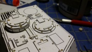

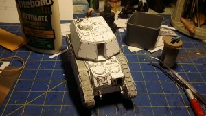

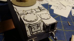

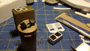

Hull and treads completed enough to assemble the main assembly and prime! Turret greebling has begun with the commanders hatch and copula.
20200519_222600.jpg20200519_222556.jpg20200519_214604.jpg20200519_205046.jpg20200519_205028.jpg

Got some work done. Mainly greeblies on the turret working toward prime and paint. Not quite at the priming phase, but closer....
...got distracted by a combination of wedding anniversary, birthday, Memorial Day (US), and building a new PC. I managed to get a couple hours of papercraft in however! Here are the results:

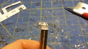

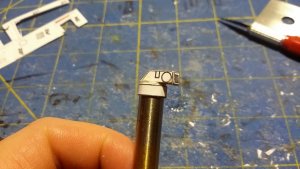

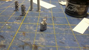

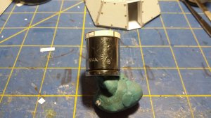

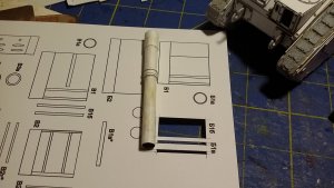

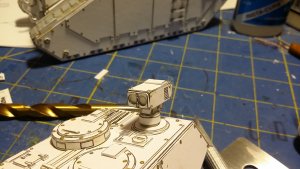

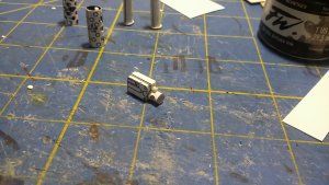

Finished hatches and the base of the missile launcher. Instead of rolling the paper tube, I measured the diameter of the part that fits on top and cut a 5/16" diameter dowel to length.
While that was drying, I took some CA glue to the hand holds to seal them a bit better as I cut them from a few layers of laminated card:
Then I finished the missile launcher:
20200526_182003.jpg20200526_182007.jpg20200526_182324.jpg20200526_184600.jpg20200526_184617.jpg

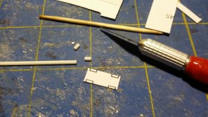

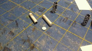

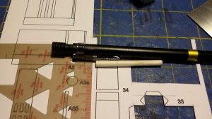

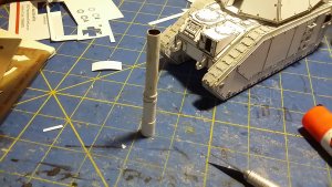

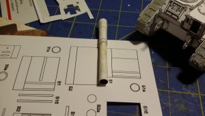

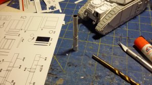

Now I am working on the main gun. Instead of making the barrel from a few segments of rolled card, i took meaasurements and made the base tube from a single piece and just cut other gun tube greeblies to the appropriate length. Moslty by wagging it and using trial and error (mostly error).
For the base of the tube, again, I skipped some tube rolling and opted to use some paper sticks (found in they DIY candy section of your local craft/cooking store).
