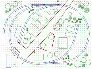

    Thanks, David. I might look into the black foam road bed then, basically to create the raised appearance.
    I'll probably use preformed track b/c I think it might be difficult to achieve such tight curves with flextrack. The layout calls for 14.6"R Hornby curves, but do you think I could still create the same layout with Atlas 15"R curves or would I have to make the layout bigger? ... Apparently, Atlas has some free software where you can create and test layouts on a computer but it's not available for the Mac! :(
    Thanks,
    Rob
  16. Squidbait
    Squidbait Recovering ALCO-holic
    Jan 27, 2007
    1,257
    Rob,
    You could do the layout with Atlas 15" curves and Peco small left turnouts. I don't have time this morning to try it with sectional track, to work out the count, but with flex track and no easements, you see you can squeeze it into the space. If you use sectional track, you'll probably have to cut some pieces to fit.

  17. RobertInOntario
    RobertInOntario Active Member
    Mar 23, 2006
    1,409
    Thanks for posting this. I think I'll end up going the sectional route b/c (based on experience!) I could have trouble creating such tight curves with flextrack. I'm sure I'd end up with kinks and 'inconsistencies' that would cause derailments! Rob

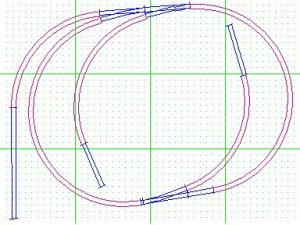

  18. Squidbait
    Jan 27, 2007
    1,257
    Rob,
    Here's the parts list to do it with sectional track. The pink pieces in the plan are sections of 15" curve you'll have to cut to fit.
    I'm going to cross-post this into your other thread, as well.
    Track:
    4 Atlas 821 9" Straight
    19 Atlas 831 15" 30D Curve
    3 Peco SL-92/192 LH Small turnout
