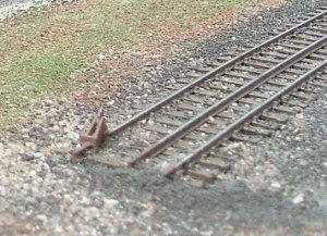

Just picked up on this thread...here's my response to your original questions. I spray paint earth, tan, or brown colors to rail already installed. Before it dries, I wipe the tops of the rail clean (almost) with a paper towel. I come back later, uually the next day and use a Brite-Boy cleaner to finish up. If you paint flextrack before it is installed you will have to touch it up on curves after it is laid. For me it doesn't matter that the ties are the same color as the rails, on most of the prototypes near me it's hard to tell if there is significant difference. Here is a picture with some before and after.
A few other things you can try for weathering rails.
- Put a little oil on the rail top, this way the paint will not stick to the top of the rail.
- I like burt umber and black craft paint, with a paint brush
- and my favorite after its done GOO GONE the top of the rail
Now is a good time to test the track to see if there is any left over paint on the rail.
NOW its time to balist the track, but thats an other story...
Have a good weekend.

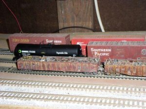

Thanks Josh for the compliment on the gons. I have also used the oil on the rails as Jasbourre suggested...don't know if I saved more time or not. Usually the paper towel gets most of it if you don't let it dry first. Either way I usually have to use the Brite-Boy at some stage anyway.
