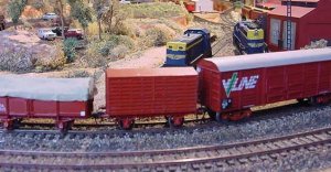

Luis,
Did you put this post in before you let it dry out? It can look pretty awful and like you've made a horrible mess while it's covered in the white goo of the glue. Or pehaps the grain size of the ballast you are using is too large? Perhaps used too little ballast maybe? I can't really think of anything else other than that.

Gee, Thanks guys for the comments about Garahbara and piccies and stuff. Yep. I'll be putting one in, but you've already seen most of the good ones I've got. Gotta "borrow that camera" again in the next day or so. And set up a couple of pics properly, rather than just rush, point & click!
Yeah, with regard to the glue stuff, I was horrified as to what I'd done when I first did some ballasting, and especially the scenic stuff. Looked like there had been a blizzard or something, with all the white glue! The next day, however, it came up beautifully, and stuck like the proverbial to the blanket!:eek:

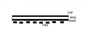

there only one more question that i have for you. what should i do, if the ballast is guled to rails? you know, sometime little pieces of ballast stay glued on the rails... and it gives a very jerky and smoothless train running.
Vic
Feb 1, 2002
1,699
79
Columbus GA
Hi Luis, If you have some glue on the tops of the rails just clean if off with a track cleaning block or some real fine emory paper.
Sounds like you may have some ballast in the inside web of the rails. That's the area between the top and base of the rail ...see attached pic.
Just take the point of a knife or a real small screwdriver and slide it along the inside web of both rails and scrape the stuck ballast off and every thing should work OK. You have to clean your track real good after ballasting.
