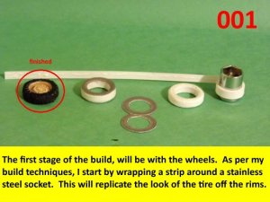

In between building my Viper, I came accros trymodels scout car. You can download it here http://www.zealot.com/forum/downloads.php?do=file&id=1630 This scout car is known by other names and in different variations. The dingo is the name it is best known as but it is also known as the Bison and the Lynx. The basic shape is there but as usual, I will try to make it more detail within my capabilities. The first stage of the build, will be the wheels. This procedure can be used for other vehicle builds to include warhammer. Thanks for the model Trymodel and I hope to do it justice.:thumb:

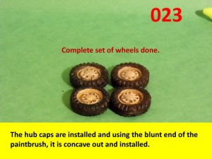

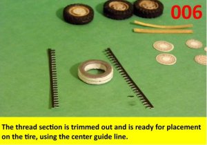

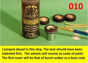

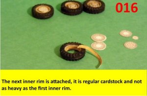

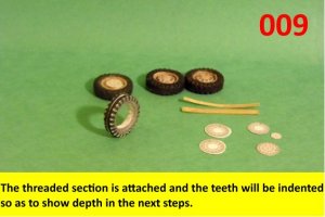

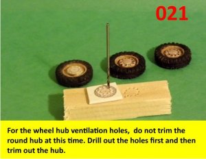

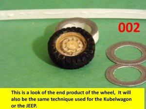

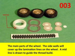

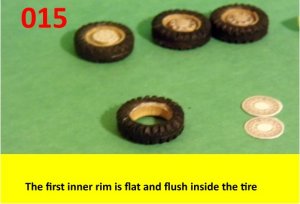

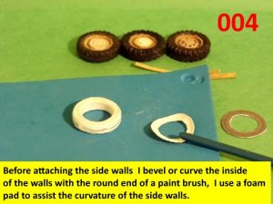

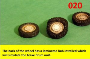

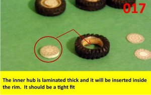

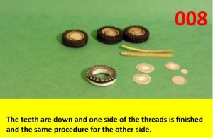

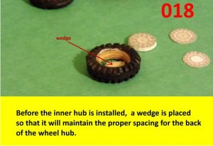

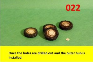

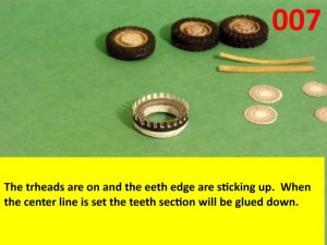

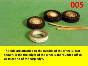

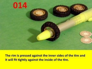

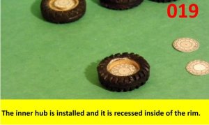

Here is the next batch of photo updates. I did the wheels first, because they are time intensive. I make my wheels different from the known techniques. The next posting will be on the chassis, suspension and axle arrangements. Enjoy and see you all soon.:thumb:

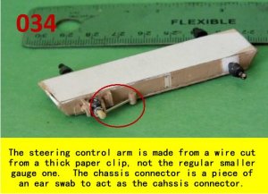

silveroxide
Aug 22, 2007
2,036
525
Fayetteville NC
Daimler dingo

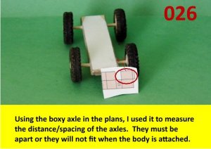

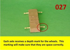

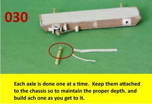

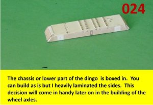

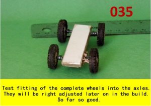

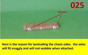

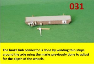

With the wheels done, it is time to go to the chassis and the body of the Dingo. The first photo is a teaser as to where I am at the moment. The interior is coming out better than anticipated. Working with the BSG Viper has helped in the detailing of this small vehicle.

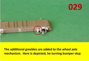

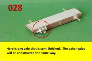

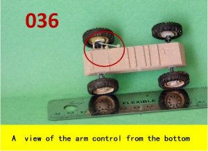

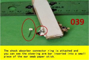

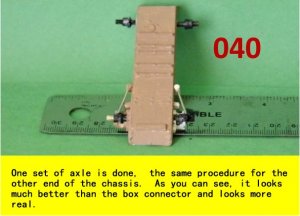

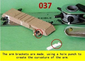

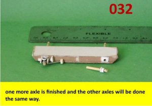

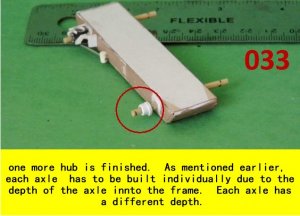

So here is the next batch on the chassis and axles. The next section, will be on the cab construction. That will be a bit tricky in that the cab is not done in a forward seating arrangement but slightly canted. Enjoy and see you all next posting.:thumb:

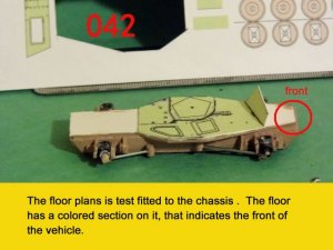

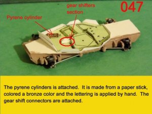

Dingo/Bison

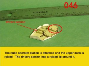

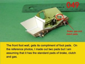

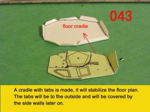

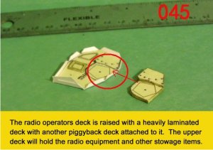

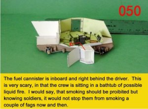

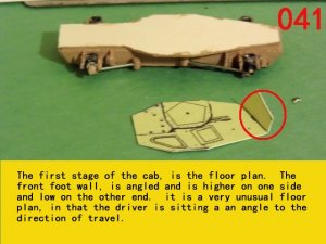

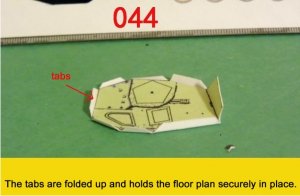

Continuing with this small project. The main unit is finished, now the only things left, are the extra stuff and details. The last photo commentary, is not meant as derogatory. A fag, is an English term for a cigarette. As you can see, here is where the scratch building really begins past the wheels and axle system. Enjoy and see you all soon with more updates.

devilThat's kind of dangerous because whatever your disposition, they could always shoot back at you, if you're going to try and smoke someone, better get them the first shot.:boom: Still don't see how that would cause a problem, except with the return fire.:joust1: :eek:. Those tanks are probably lined with 1" thick rubber bullet shielding, and I am almost positive these are all diesel, which solves many problems.idea1
*Disclaimer:I may have mis-read this with the idioms used, cultural precepts. and all. :)
angel
silveroxide
Aug 22, 2007
2,036
525
Fayetteville NC
Dingo/Bison
angel
The M-113 are a multifuel engine now but in the early days of the Indochina war, they had gas engines and the fuel cell was right in the back by the exit ramp/door. The enemy knew where the fuel cell was and would aim for that part of the APC. Other than roadside IED's, This probably led to many GI's to ride topside. Besides, with all the gear on board, it was very cramp and hard to exit the vehicle. If the fuel cell ignited, the soldiers would have to face a wall of flames to exit the ramp. The APC's were bullet attractors, which led me to join small unit operations like recon teams.

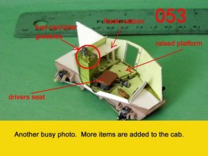

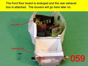

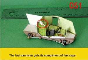

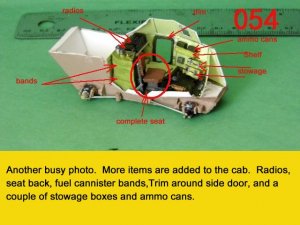

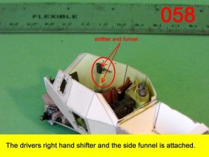

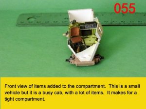

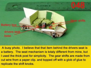

In continuation with the Dingo, Here again is a teaser photo as to where I am at the moment. As you can see, I hand painted the vehicle a NATO green and added the unit identifications for an SAS, Rhodesian Army scout vehicle.

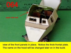

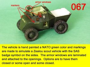

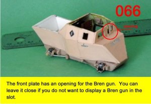

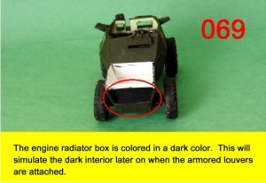

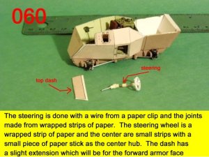

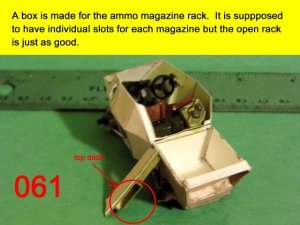

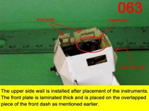

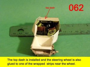

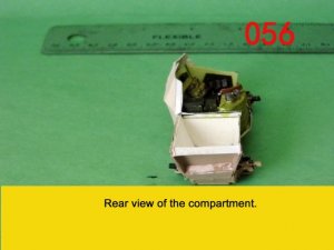

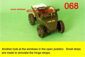

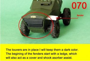

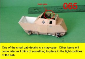

Still working on the little fella, The model that Trymodel has design, seems to be the Mark-I, This one is the same but with enhanced add on's to make it more compatible with the Mark-II or later. One of the biggest changes to the models, is to the rear engine radiator louver shields in the back. Here is the section of the build where the coloring changes. As with my ALIENS APC, I gave the body a base coat of black, and then colored the overall vehicle an olive drab. The steering column was a bit tricky but by using the paper clip wire, I was able to bend and form it to the right angles. Enjoy and see you all next posting.:thumb:

Yes, the Dingo did have three pedals on the floor, but some of the later ones also had (iIrc) a pre-selector gearbox, subsequently deleted and those vehicles returned to standard manual transmission, because the pre-selector was not sufficiently rapid in changing ratios.

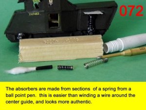

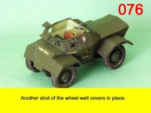

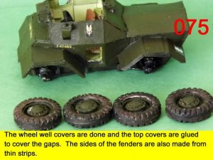

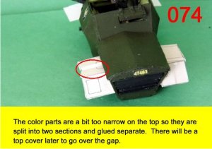

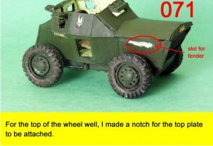

Here are some more photo updates on the build. The model is almost finished so all I have to do now is edit the photos. I wish that my graphics program had a spell checker. Sometimes I go over my threads and cringe at some of my misspelled words. Enjoy and see you all soon with more updates.

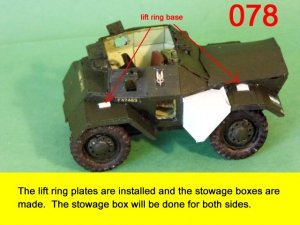

Dingo/Bison/Lynx
I watched with bated breath the construction of this model. In the dream, I would not think that is possible from a simple model to do. Especially when the size of 1/35 (the length is 9 cm !!!). Masterpiece, very inspiring, beautiful work. Thanks :thumb:
tryModel

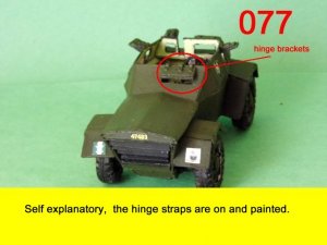

There are a lot of smaller details, that I had to do without, and when there is a wealth of reference material out there, it sure helps in the construction. Thanks for the model, too bad that I am not that good in making the printed details.

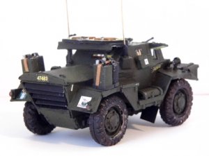

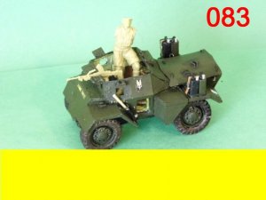

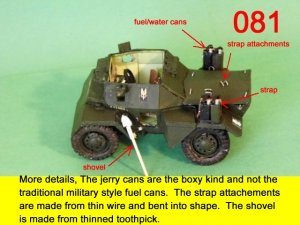

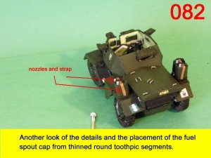

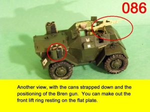

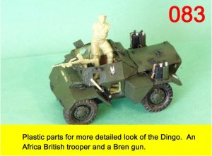

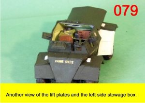

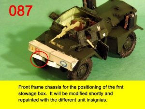

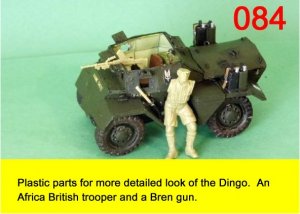

The Dingo/Lynx/Bison, depending what country of origin, is finished, I have to do the editing and post photos from here on. Be patient and the first photo is of the finished model. Stick around until I get to that point in the future. Enjoy and see you all soon with more photo updates.:thumb:
