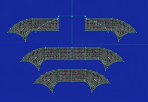

    Well gang,
    I've been bashing it around in my head for some time now, and I just can't figure a way to make the flight pods retractable. The attached image illustrates the problem. The light blue lines in the top arms show the hull outline where the arms intersect it.
    The top pair of arms are in the fully extended position,
    the middle pair partially retracted,
    and the bottom pair are in the fully retracted position.
    I simply haven't been able to come up with something that works. The space inside the hull is about the same length as the upper arm, so the arms need to slide inside each other, or "telescope" somehow. On an 18 inch model we only have about 3cm (1 1/4 in) in which to build the mechanism, and it needs to collapse to at least half that size.
    So, unless someone has a solution I'm going to design it so the model can be built with pods extended, or pods retracted, but no retractable landing pods.
    Getting close now, but I've been very busy with work and other life stuff lately. Getting back on track now though.
    TTFN,
    SJ

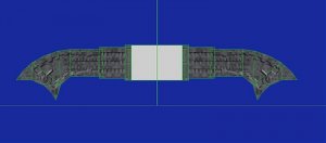

    Thanks for this :wave:. It's exactly what I needed to stimulate the old gray matter. I've done up a quick test in meta and unfolded it, and will start a test build tonight. I'll post pics and stuff as soon as I can. I've still been stupidly busy with work lately, and haven't had much modeling time.

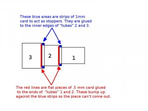

    Retractable Arms
    Great news gang,
    Thanks to CJTK1701 and Theo I've worked up a method for retractable landing bays. Instead of folded flaps though I'm using strips of thick card, or layered card.
    The attached image illustrates the method, based on what CJ and Theo illustrated earlier. It turned out to be one of those "couldn't see the forest for the trees" type things. Once I got on the right track it clicked right in.
    The telescoping portion of the arms are roughly square. The diagram below shows a cross section of the arms.
    As piece 1 is pushed in, the red "plate" at its inner end hits the red plate at the end of piece 2, and piece 2 starts moving in, until it hits the end of piece 3. When pulled out again, piece one moves until the red plate hits the blue stoppers inside piece 2, then it starts pulling piece 2 along with it, until the red plate of piece 2 hits the stoppers inside piece 3. Simple, and very effective. The same technique could be used with cylinders to simulate hydraulics, telescopes, telescoping legs, all kinds of good things.
    Last night I built a test piece using blue stopper strips on the outer edges of pieces 1 and 2 (more like CJ's original sketch) instead of the red plate, and it worked like a dream. I came up with the idea of the plates later, since it increases the amount the overall tube shrinks or grows. It might not be as strong, but I'll test this technique as well and find out.
    Happy dreams!
    SJ

  13. theo
    theo Member
    Nov 9, 2007
    99
    Good solution, that should work.:thumb:
    When I was looking at it the first time I couldn't understand wy there were 3 parts to make the arm.
    But the third part is in the hull of the Galactica an the outher 2 are on the out sidewall1
    I'm not stupid, I'm just slowsign1

    Retracting arms
    Howdy all.
    Haven't had much energy around 3D work lately. I've been more into building. Just got wind of the free model competition and have an idea for an entry too. Good thing I have until June sign1.
    I've fine-tuned the landing bay arms and tested the two different techniques. Using solid strips seems to work better. The "plates" don't support the arms as much, but it may not be significant. As soon as I can I'll send some test builds to nothing and skupilkinson, and we'll see how it shapes up.
