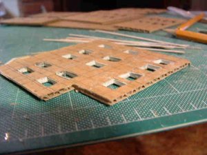

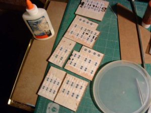

Not much done as I left on Friday to go north to my daughter and son-in-law's home off of highway 17 between North Bay and Sudbury. We went to see my grandaughters Sunday School Christmas concert. Had a great visit up there and returned home today.
A tedious part of this type of building is glueing in cerealboard strips into the window wells. There are 56 windows to do in this building.

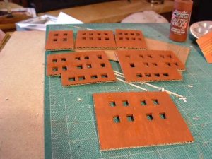

I know this must be boring stuff but you did ask for the steps.
Here are the walls with first coat of paint ready for window details

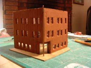

MarkB Much depends on the type of building I am doing to join segements. In this case I have trimmed the edges to a 45degree angle so when the joins meet they won't be visible. When I get to that stage I will take a photo to show you.

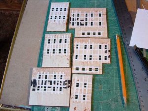

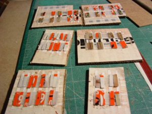

OK I hear you so will try to make this more interesting.
This is the back side of the walls so you can see how I glue strips of white paper to make window frames.

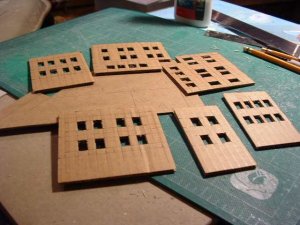

That's correct Tyson.
This photo shows it with the "glass" in place. I use those plastic tops from coffee cans. I like it because it isn't clear so give the effect of relected light and shows up better with interior lighting.

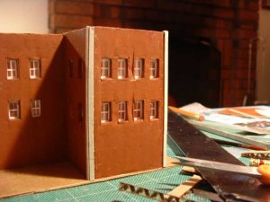

Next I added curtains. I found lots of curtains in Sears catalogue. Just cut them out when the wife isn't looking. I cut tthem into strips and glue them in place. Some closed some partially open.

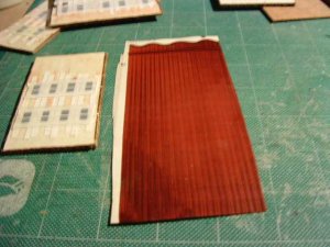

This photo is for MarkB showing wall joints. I cut a strip of cardboard and score it down the middle then glue it around the corner much like real buildings that have a slightly thicker wall at the corners. I still have work to do on the exterior of the walls.
