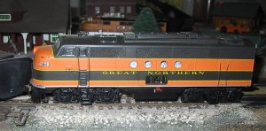

  8. KentBy
    KentBy GN, NP, SP&S
    Feb 1, 2008
    97
    For anyone that hasn't seen the light side unit.
    I took this picture and hope that I upload it correctly.
    Kent
