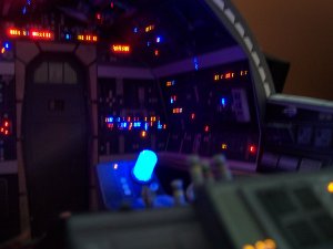

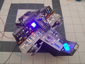

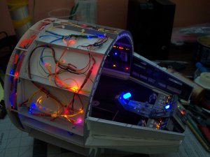

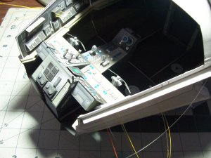

Now we are really getting into the lighting of the model.

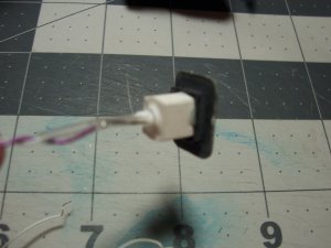

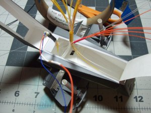

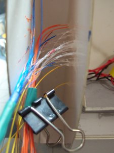

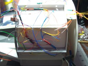

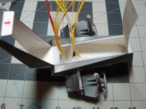

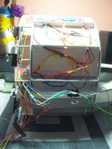

Now all the fiber-optic cables are clearly marked, I bundled them together accordingly using heat-shrink tubing. Shrinking has to be done with care as it can cause damage to the fibers in the form of melting completely or bending into a crazy-straw looking thing :hammerhead:. Another problem that happened along the merry-way was that if the fiber is inadvertently tugged a bit too much, it could be pulled right out of its plug-hole :yesyes::sadno::headbange:. Dang, it sucked when that happened! I then had to find out where it came from, re-drill the hole, feed the fiber back in (not an easy task) and then glue it a few times to the surrounding stuff to get a good strong anchor for it. It only happened about 20 times :eek:.
There were several ways I was going to tackle the fiber-optics before settling on the method actually used for this model. I was thinking to start with of just making the fibers all very long so they all land in one place. Maybe at the bottom of the model? This would mean there would be a huge bundle to deal with, trying to figure out any mistakes or issues with a broken fiber would be hard to say the least. Also, routing the fibers through the bulkheads and other stuff could get ugly especially if they all needed to change due to a update in the structure of the model. You would also need probably 4 or 5 times more fiber, and I already used about 150 feet so that would be about about 600 feet of fiber needed to do it that way! :blueface:.

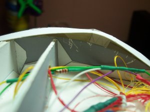

Each bundle of fibers has its own light source. This is in the form of a colored LED. Each LED has its own resistor based on the DC power that I wanted to use.

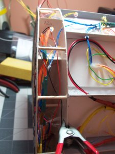

You really have to make sure to use a bunch of the white Elmer's Extra Strength glue to hold these fiber puppies in.
I found that the springiness of the fiber-optic cables and the wires in some areas made them protrude from the insides. This won't be any good because the outer skin of the body needs to be able to freely slide over the cylinder shape of the main body. There cannot be any protrusions or that just ain't gonna be an option! So, I made some of these little tie bases to hold down the goodies where needed. They work really good! I just glued them on, and then wrapped the wire around the bundle in question. I think I used about 20 of them.

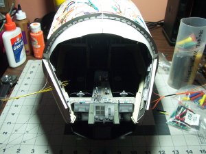

I also spent time strengthening and aligning all the frame parts as I went along. I used some 3mm round spruce wood to brace the sides of the bulkhead. Man, that made a super difference in the alignment, and the strength overall. It also doubled at keeping the guts of it all inside the model as can been seen in the picture below.
Clamping is also a necessity using various methods such as paper-clips, tiny clothes pins, plastic clamps, masking tape and so on.

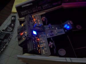

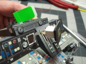

Here's the control console being retro-fitted with the fiber-optics. There was really little advantage to drilling the holes prior to assembly as it was better to make those judgments on the fly! It may not be possible to light every single lamp on the models cabin, dashboard or whatever, and when its built, you can be sure it will be seen.
I made it so all the fiber-optics and associated stuff would be contained inside the console as a single unit. The console still swings as usual with no interruption.

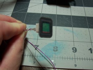

I couldn't resist making the display on the dashboard glow as on the actual M. Falcon. It was a bit intricate to make it happen, but it turned out pretty nice I think.
The semi-transparent screen appears green, but when powered up is a light-blue color.

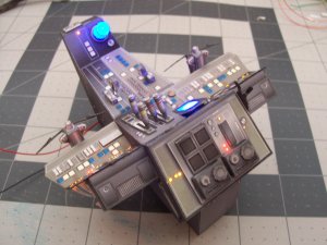

Just some pre-installation testing to make sure everything works as it should. Some of the lights flash too to add a little contrast to it all. Oh, yes, and the what looks like some kind of "flux-capacitor" item at the back of the console, I just couldn't resist making slowly pulse blue with a heart-beat rhythm. I have a tiny video of that somewhere.
None of the fibers or wiring details can be seen to give it all away. Just two thin wires coming out of it is all.

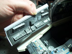

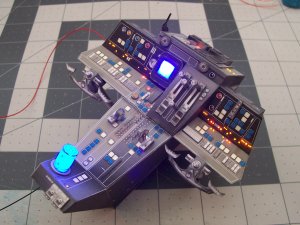

Time to attach the console to the main body of the M. Falcon. By the way, you might be able to see how little clearance there is in comparison to the Black Series Star Wars characters body and legs. There is just way too little room.
The side panels. They also have fiber-optics installed in various locations.
Another quick test to make sure all is working. Each LED, fiber-optic is checked for correct operation, color, brightness, and so on.
We have light! The sides of the cabin at the front have not yet been completed in this picture.

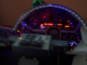

Site you found is best reference I know of. Your model is fabulouse. It is pitty that some photos are blurry.
Thank you for your comments. Sorry for the blurry photos. I will be taking better ones of the finished model using the tripod. The lighted shots need a very steady hand.
Thanks again! thumbsup

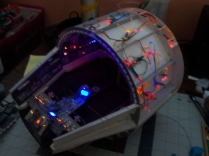

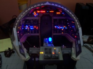

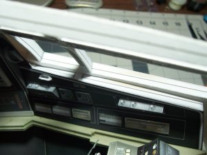

I found a few more photos that I took that aren't quite so blurry of when testing the lighting on the M. Falcon.
The sides that lift up that allow you to take photos of the inside of the model, now do not require paper-clips to hold them in alignment in the closed position. I braced the doors/lids so they are more solid with glue-gussets, and pieces of cardboard in the corners where needed for added rigidity.

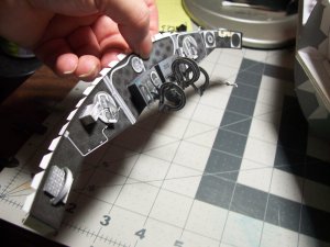

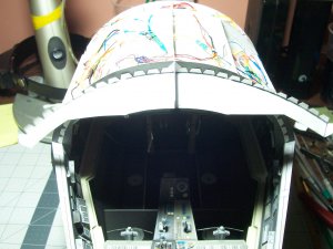

This is the top panel that goes above the heads of the pilots. There is a nice touch that UHU02 added of a pair of furry-dice that hang on a string from above. Trouble is though it's very delicate, and I will need to re-attach them again at the end of the build.
With the upper panel in place, it makes it very awkward to experiment fitting any kind of figure in the cockpit. Everything clashes with those round hoses that hang down as you try and wiggle the figures into place. Oh, also, the ends of the upper panel are a bit too long and needed to be trimmed just a little on my build.
This is where I started testing the attachment of the nose-cone onto the main body where it slides into place. At least it is supposed to :realmad:. This required a lot of finessing to get it to fit right. I took a photo of one of the typical issues below where the edge was being forced upwards away from the bulkhead. I had to trim away in a few places. There seems to be no quick way around this. You just have to slowly go around the edge fixing each point working on about an inch at a time, cutting, trimming, and sanding the area where the two join. The problem will be is if this is not corrected, the main outer skin will not slide over into place accurately. It will snag on the edge(s) sticking out, and will buckle, and possibly tear the paper if you don't notice what's going on, and that will be a disaster!! It would likely mean re-making the outer skin over again. The outer-skin is very delicate being only a single thickness of paper. Ideally, it could do with being strengthened by layering it at least on another sheet of paper. The only problem then of course is that it wouldn't slip over the main body into place being to thick! :sadno:
This is another area I decided to modify. Its where the tops of the side panels are supposed to slide into an area that was left unglued in the frame at of the bottom of the windows. If you accidentally didn't leave them unglued, then it will be tough to separate the pieces without damaging them! Then again, if you want to put "glass" in the windows, then this design would make it hard to do so!

Also, you can see the fiber-optics starting to be installed into the side panels.

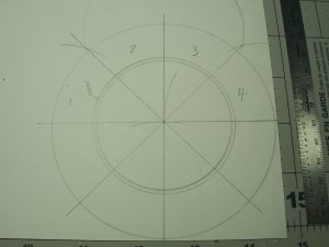

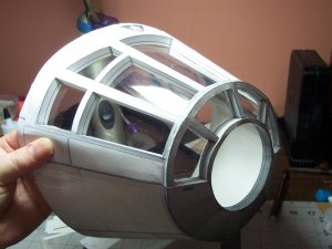

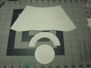

I designed templates for the windows on paper. This is the one for the front windows. I always knew my drafting interests would be useful one day... wow, that was before computers were the norm! :Computer: :Smartass:

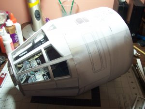

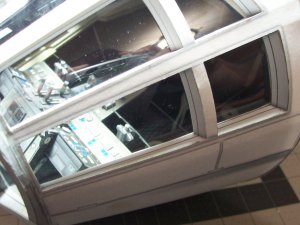

Here are all the windows glued into place. I was originally going to cut out individual windows but I found it better to just make one big wraparound window for the large "side" windows area. The windows do seem to add something to the appearance of the finished model :yesyes:.They just need cleaning with a little Windex and Finish to complete the job :Drinks:
Here are all of the window templates. I used overhead projector film for the actual window material. It seems harder to get the 100% clear stuff any more?
It is a large model for sure! "Star Wars theme song going in the background.... de, de, de, du, du da......".
There are a bunch of details to add to the outside of the model to greeble it up! Yes, sir! That's gonna keep ya busy for week or too!!
The nose-cone slides on real nice now! Snug-as-a-bug-in-a-rug!

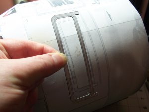

Pre-rolled to match the contours of the main body outer shell. If you don't do that, it will crease up in a nasty way!

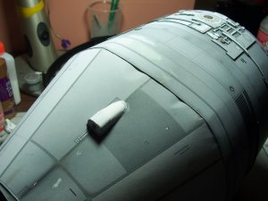

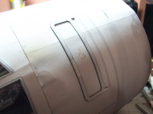

Lots of detail added to the undersides towards the back. It looks like some kind of sensor the scoop looking deal on the front? Is it supposed to be a light one wonders?
The bottom area of the nose-cone is straight at the back. It slowly tapers into a flat section. It does make it harder to seat the thing properly, and can easily cause a situation where you want to pull your hair out! :headbange::realmad:
I used a fairly thick cardboard to laminate the details to as I wanted the embossed effect to be easily noticeable. (Waiting for the glue to dry!)

Awesome work on the windows and wiring! :Bravo:
My wife said it doesn't look good without windows, and I think she was right!
The wife is always right, they say. I can neither agree nor disagree with that since I'm still single. :Grin:
The sheet I get at the local store has a slightly blue tint. Till I have found something else I use the PP from blister packagings.
