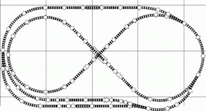

    the 9-3/4" limit is because that's what the majority of the turns in my layout plan are. (I'll attach the image below) The track plan is fairly simple (and currently is about 30" x 55"). It should look like a kids play-trains set, as I have no yard areas or industry spurs. The main reason for that is that a yard area or spurs is an area that the lead, pewter, and plastic figures can't move around on for wargaming. Many use a metal base, so I don't want them standing directly on the track! The modular terrain will go inside the circles of the figure 8 and along the outside. The only permanent terrain will be the piers and bridge in the figure 8, and those i hop to have the option of turing into 'hills' by covering up the piers. This way we don't fight over the same mountain every week!
