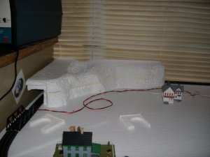

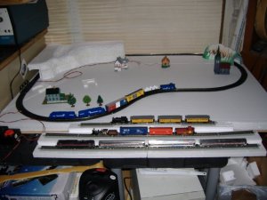

Here is my current progress, for now the track and roadbed is held down using sewing pins. the wiring to my structures is also just pinned down, And I just finished sculpting on my mountian and cutting out gfor my portals. I need to cut my pond and river on the lower section from the waterfall to under the bridge, then I will build my frame and sideboards and finally clue it all down. After that I will figure out what other structures, trees, roads, etc to ad, then I will start on all that. It will take a bit longer but I am having a blast. As for trains set I got 4 different ones (The Little Joe, Diesel Chalanger, Prairie Flyer, and The Centennial) all are not bad, but I will be looking at better Engines and Cars later. Below is a few pics of what I have so far.

I used Woodland Scenics single portals, but because I errored in my layout size I has to trim the side in half.
