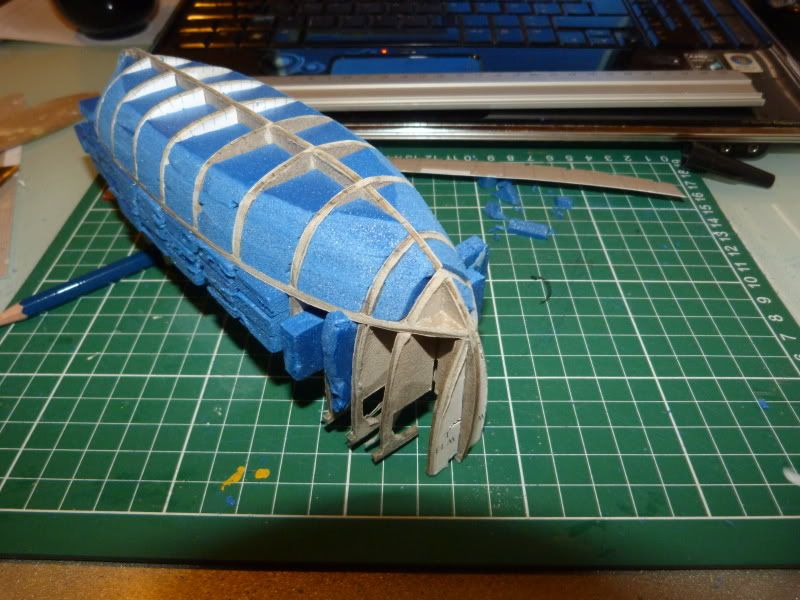

    Well, the frames have been complete stuffed with styrofoam, and the deck has been installed.
    [​IMG]
    Even though, according the kit, the deck should have been one piece, I found it completely impossible to install, so I have made a clean cut lenthwise and installed it in two parts.

    How do you sand styrofoam without making a ruddy awful mess? I've only tried it a couple of times and probably did it wrong, but results were not pleasant.
