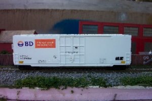

This boxcar was done using Fusion. It went on smooth, no runs or drips, dried quick and took decals really great.

Thanks for the reply. The boxcar looks great. I hope I can get my locomotive to look just somewhere close to that good. I decided to hold off painting it until this weekend.
