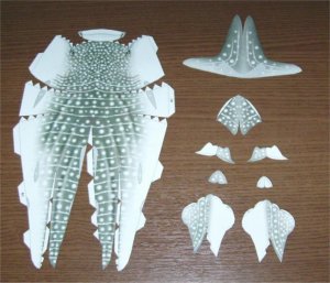

The second pic shows the whale shark parts already cut, almost ready to build, I still need to score some tabs before to build it.
I will post more progress pics as soon as possible.
