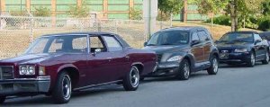

And here I thought you were a beatles fan :D :eek: :D Nice car!!!! I Love the Flames!! :) Welcome aboard!! I was thinking of making a "Shelf" layout in N or Z just for the rear of my PT. (2002) Somebody just suggested it to me in the chat room a couple days ago. :) Did you know the power outlet in the rear only seems to turn on with the Ign key on?? At least mine does... I run my Z gauge with a 9V battery. All you would need to do is build a regulator circuit. and drop the voltage to 9V. I haven't experimented with N or HO yet.
Here's a site for Circuits
So where abouts do you live??? I've had the Woodie in a couple cruises & I'm entering it in a show in Sept. I also have a '72 Catalina that I show at the antique car shows. And the Mustang is mine too. :) btw - the building in the background is one of the only remaining Baldwin Lima Hamilton buildings.
