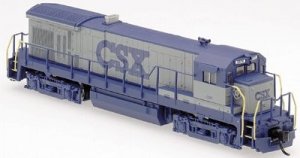

    Didn't you post a photo of a blue and gray B30-7 recently, or was that someone else? It had AAR trucks, so it represented an ex-Chessie unit. The paint scheme is appropriate for late 80s-early 90s.
  9. Cheetah20
    Cheetah20 Member
    May 15, 2007
    105
    yes..good memory...
    whats wrong with it?...what am I missing? sign1

  10. Triplex
    Triplex Active Member
    Aug 24, 2005
    1,849
    There's nothing... wait a minute, it has no number on the cab.
