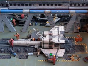

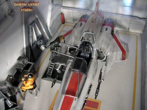

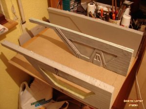

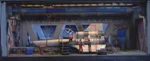

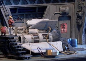

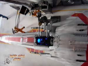

I keep referring to resinilluminati.com for build ref. It is a great site full of ideas. While it is mostly resin and scratched built studio scale modelers, many of those works can be transferred over to paper. I would post the link to the builds, but they will not come up until you join, which is also free. here are a few downloaded photos fo what they have over there.

Thanks for the help, guys!
Silveroxide - I registered over at resinilluninati and I'm slowly culling through everything that's there. Thanks for the tip!
