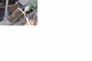

my girlfriends's t6a radio
You are a lucky man to have a girlfriend who shares your hobby! My ex wife is sculpted into the cockpit of the big SAAB jet! 55% of SAAB cars are bought by women and the Swedish air force does have female fighter pilots. So, the guy who commissioned the model commissioned a 1/4 scale female pilot too!

Ex wife in G suit and Swedish AF helmet. Zealot software seems to shrink stuff, but you get the idea.

Neat :)
