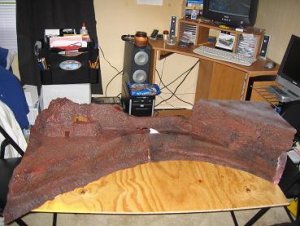

    Below are a few pictures of my layout (Or the completed fraction, at least.) First, a panoramic (well, as panoramic as a 620x280 jpg can get) view of this edge of my layout.
    On the far left is the mine, in the middle you can see a place where an old avalanche has been filled in behind a rockwall (by the unpainted plaster), and on the far right you can see the bluffs and the caves therein.
    The train will run along the ledge from the mine to the termination of the ledge under the caves, where it will cross the canyon on a bridge. There will be a creek in the canyon, as well as some vegetation.
    Also notice my opulent living conditions, complete with three course banquet (Peanut Butter Creme Double Stuff Oreos). I live in a one room hole and this blasted railroad takes up more space than I do!

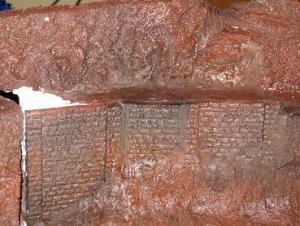

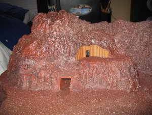

    Here are close-ups of the aforementioned mine, the rockwall, and the bluffs and caves. When all is said and done, the rockwall will be painted stony gray and I'll stuff something behind the caves so you can't see clean through the layout.

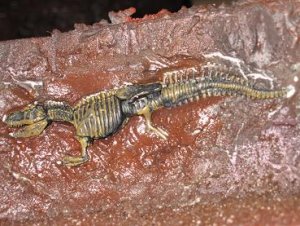

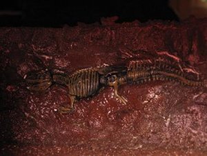

    Dr. Carter, from one of the big museums out east, has made the find of a lifetime with this well preserved Tyrannosaurid. One picture has too much flash, the other has too little. This needs to be touched up a bit, I'm going to plaster him in there a little better so it doesn't look like he's about to jump out.

  18. Doc Holliday
    Doc Holliday Member
    Oct 28, 2002
    614
    Your dino looks great! What did you do to weather it?
    Doc
  19. stormfather
    stormfather Member
    Feb 28, 2007
    33
    Actually, it was like that when I bought it. I got it in an educational toy store; when I saw it I knew it had to go on my layout!
