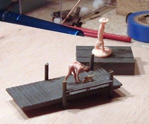

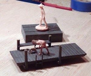

I use all brands including Model Power, which are reissues of the old Plasticville dies. Like a demented Frankenstein, all my LPBs are merely an assortment of appendages, torsos and noggins to rearrange at my whim. I make up a putty out of the sprues leftover by dissolving them into small bottles of Testors liquid styrene cement, making sure that I keep the diiferent plastics for the various brands separate and use them only for the brand they come from.
This is an example of my work on LPBs---I enjoy classic oil paintings and so thought of this female form as a good challenge. She was cut off at the waist from a Plasticville brakeman. Her torso came from the farmer shown then glued to the legs as though she were bent over. After carving off everything that didn't look like a girl, I then built up her figure and hair with blobs of the styrene putty, let it set, then carved it to shape. Once hard set---about a week---I painted her with a coat of styrene cement to soften the rough edges of the carving. It seems to help harden it some as well. Some well placed paint, a Prieser dog (repainted, of course) and a kitbashed pier completed this mini scene. Once I thought of them as parts of a whole, my citizenry started growing by leaps and bounds. More often than not, I simply relocate an arm or leg, this one took two figures to do, I've used as many as five.
