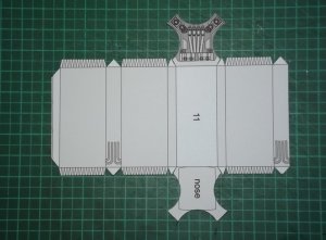

THIS is exactly what I was afraid of when I'm tackling the big ones. The nose is divided in three parts and the panel lines do not correspond with the seams. That is due to the original design. They built the mockup / model and put on whatever they thought would look best without following the position the wooden skeleton. I know the evil man with the whip will not stop bugging me to shift the lines or seams to make the nose as smooth looking as possible (I KNOW YOU WILL, THERE IS NO DENIAL!!! :Grin: ). I'll add separate panels which are to be glued over the most prominent seams. I guess that will please everyone, even the whip man. ;)

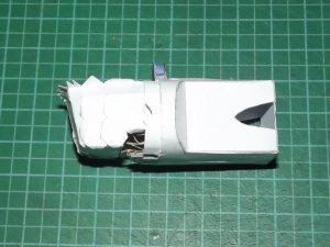

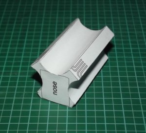

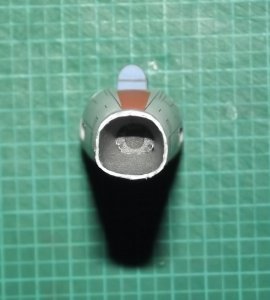

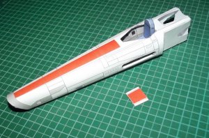

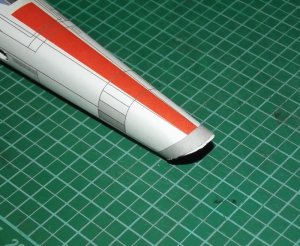

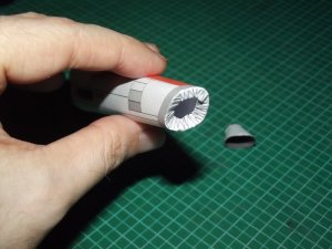

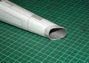

The glue tabs stretched the front of the nose outwards and were cut off. Now a glue strip ensures a smooth finish.
Using a rod I pressed the flaps of the cockpit tub against the upper side of the nose.
A good view at the falling off upper line of the nose.

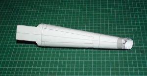

Now the inner cone is installed.
A small part at the tip was still visible because of the thickness of the flaps. It is simply cut off.
Shape test passed! :)

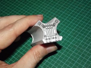

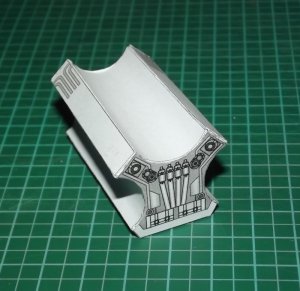

The edge will be painted with dark grey later. Now on to the engine block.

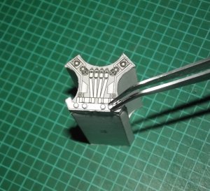

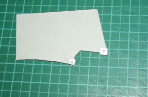

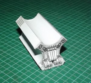

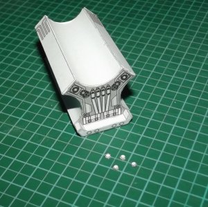

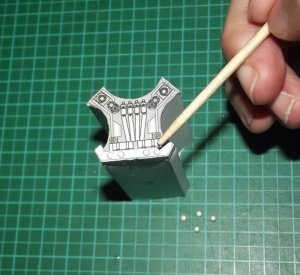

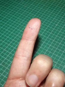

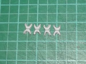

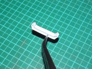

Four tiny circles have to be added. They are glued to 1mm card. It is easier to apply the glue to the block and then attach the circles with a pair of tweezers.

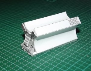

Next step: The fin and wings.

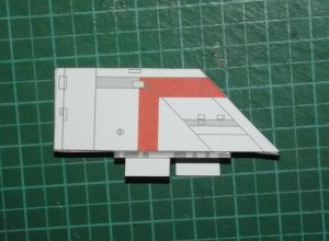

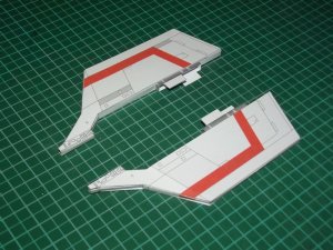

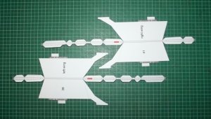

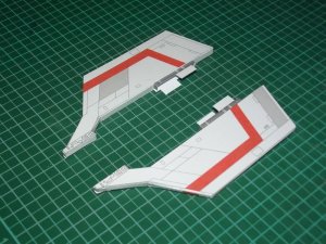

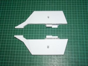

Assembly is pretty straight forward. The wings are hollow. There are many ways to increase stability. In this case I chose a rather unconventional one.
The wings are made of three parts, a core and two plates. The core is basically what you would expect but it has no texture.
The texture is achieved by laminating the plates to the core.
There are two reasons for that: First, the lamination gives strength. Second, on the studio model and the mockup have a step around the perimeter of the wing. The plate can be cut a bit smaller to increase this step effect (because it is a real step ;) ). You may further increase it by laminating the plates to some leftover paper before you attach them.

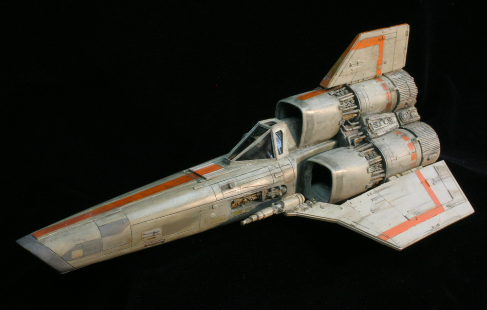

This image shows the step on the original miniature clearly:
You can also see that the orange stripe stop at the step, so there is no reason to paint the edges after the laminations. ;)

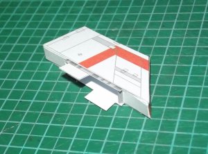

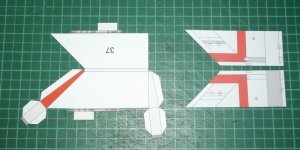

The fin:
The fin and the wings feature two protrusions which are used to keep them in place on the engine tubes.

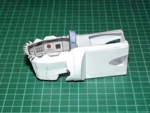

While thinking about which piece was to be tackled next I glued a plate to the nose. On the original model this plate was concealing one of the mounting points used for filming.
A view at the studio model with the plate removed:

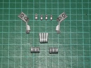

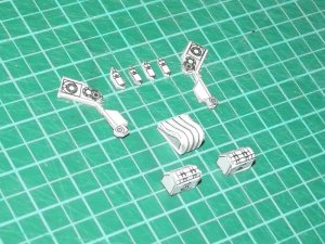

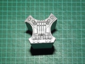

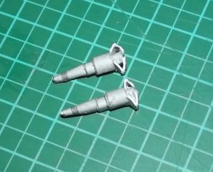

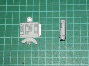

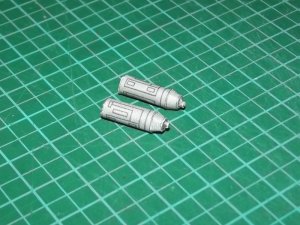

Next step: The guns.

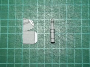

Basically they are the same as the ones that come with the Old Starfighter add-on kit.
The only difference is a new end piece:
The texture is still fantasy and has to be revised.

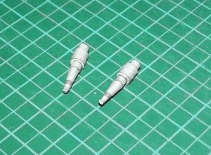

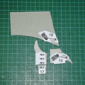

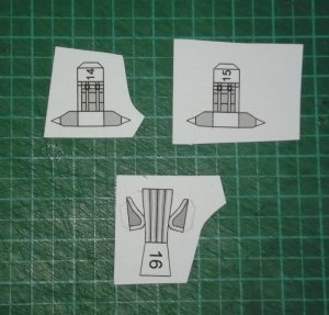

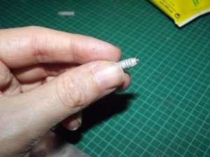

On the filming model the end cap has a small rod sticking out. Naturally this must be replicated as well.

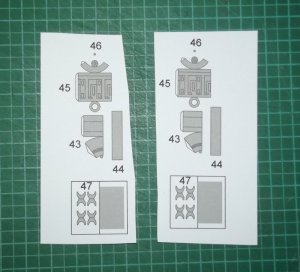

To do so the small circles 46 are laminated to 1mm card and cut out.
Yep, I know, I'm crazy! :hammerhead:
OK, doesn't look too bad..! :)

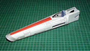

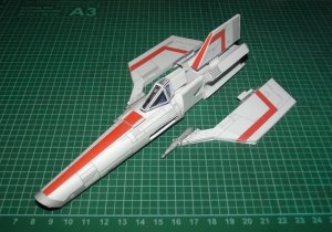

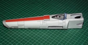

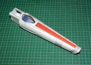

A quick setup of all parts which have been built so far:
