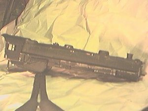

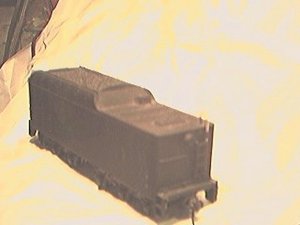

  8. curmudgeon
    curmudgeon Member
    Nov 26, 2004
    79
    My apologies for the quality - cheep camera. :oops:
    Best detail I could get.
    Google/AlltheWeb search didn't have mention of an Arbour Mikado, but 0-4-0, 4-6-0, 2-8-4 & the Allegheny, so a Mike seems plausible.
    Hope this helps.
    regards,

  9. CNJ999
    CNJ999 Member
    Aug 21, 2004
    153
    Curmudgeon, based on your photo, what you have is a Mantua cast boiler from their 4-6-2 Pacific, not their Mikado. Likewise, the tender is the standard Mantua longhaul, 6-axle, tender.
    If the mechanism is indeed that for a Mikado and everything fits together perfectly with the boiler, then it is likely to be an example of their "light" Mikado, produced for just a few years around the late 1990's. This loco used their Pacific boiler in conjunction with their 2-8-2 Mikado mechanism.
    CNJ999
  10. curmudgeon
    curmudgeon Member
    Nov 26, 2004
    79
    Hi cnj -
    You may well be right - examination of the Pacific boiler pix shows a very close similarity.
    Enough so that there could have been mods to it to produce what I have.
    Not to belabor the point, but has anyone ever seen a Mantua w/no name on it, tho'?

    This one also has no cast-in throttle assembly.
    I'll agree any of them could be filed or ground off, but that visibly changes the surface - and I don't accept that someone could do so w/o distorting any boiler bands or the sandbox sidecover, & then reproduce the original surface finish to the point it wasn't detectable under 16x.
    And wouldn't it be nice to find that Kemtron had made some?
    I'm still looking & hoping. :)

  17. curmudgeon
    curmudgeon Member
    Nov 26, 2004
    79
    And the winner is:
    Mantua - tho' maybe a Tyco version, since it doesn't have the name on it.
    Studying more pix, I'm now confident it's just been reworked a little.
    Thanks for all the input, everyone - I haven't been this interested in a Mantua since my first one 30 years ago! :mrgreen:
    regards,

  19. curmudgeon
    curmudgeon Member
    Nov 26, 2004
    79
    Actually, I'm not sure what alloy this is, but it does have the FWH, like the Mantua/Tyco.
    It isn't like any pix I found of Varney, Penn Line, Bowser or Cary.
    But Mantua had variations over the years - maybe others too.
    I stripped the paint to be sure nothing was hiding underneath, and found evidence of the generator & center throttle linkage having been removed.
    A pic I saw of a Tyco version, with those cast in, is just like it, down to the dimples for throttle rod mntg.
    Oh well - the elusive "Kemtron Mike" will have to await discovery by some other lucky feller. :)
    regards,
