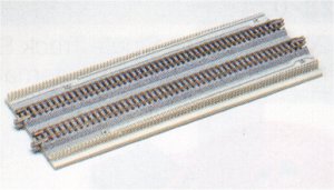

1. If I am going to be using the 23-046 double track viaduct incline pier set, do I have to also use the 20-003 double incline track plate
between the double viaduct track and the 20-001 double straight track plate?
If this is true, then I would need to buy two of the 20-003 incline track plates because my train will be descending as well as ascending right?
Why can' I just go from viaduct track to 20-001 straight plate track?
2. Does 23-046 double incline pier set include a set of piers for descending as well as ascending or do I have to buy 2 sets?
3. Does this pier set also include the S-Joiners?

I would be more patient. Very few N scalers use rising and elevated Unitrack pieces due to lack of realism. They elevate their roadbed instead.

Okay. I need things to be simple, no road beds, that is the reason I am going up and down using piers. There will houses, lakes, coal mines, etc., but all it will be is a double track that goes around my single. In order for me to stop at a station, I have to be on ground level. When done stopping at the station my train has to go back up, otherwise I am stuck on ground level and I want it to be mostly upper level on viaduct tracks. Do you understand what I am saying?

I understand what you are saying. I don't know specifically what Kato Unitrack pieces you need to do this. I have a Unitrack layout with two main lines but it is flat. I have never worked with unitrack viaduct pieces so I am at loss with your questions as to spectifically what you need to do what you want to accomplish.
Hi Pelham,
This appears to be one incline, you need two to go up and down.
This plate provides a transition to the incline. It's less expensive than the flat plate.
