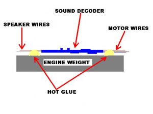

    TCH, i ONLY use sound decoders, but i hope this might be of some help to you. 90% of the time when installing the sound decoder I'll have had to shave some of the engine weight off to get the decoder to fit nicely into the engine. instead of attaching the decoder its self to the engine weight, i take a drop of hot glue and place it where the wires are coming out of the sound decoder. hot glue dries real fast and don't damage the wires. buy using the hot glue, you can glue the wires high enough at both ends, leaving the decoder "suspended" in air, letting heat easily escape from it:winki: . (see pic below) in the event that the decoder goes awry sometime down the road, the hot glue can EASILY be pulled off the engine weight, and a new decoder can be installed:thumb: . i hope this may have been of some help:smilie: .
    :deano: -Deano

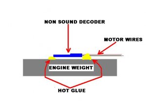

    OK, heres one for those of you that DO NOT use sound decoders:winki: .
    you would basically install the decoder just as i wrote in the above post, the difference would be on the end of the decoder that DOES NOT have wires coming out of it, place a dot of hot glue down, WAIT FOR IT TO DRY, this will only take a min or two, then set the end of the decoder without the wires down on the pad you just made of hot glue, now the decoder is still resting "suspended" in air letting the heat escape from it:thumb: . hope this is of some help:smilie: .
    Duct tape may be Red Green's best friend:winki: , but hot glue is mine:toug::119: .
    :deano: -Deano
