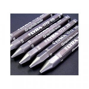

    Instead of oil, use a "2B" hardness sketching pencil or graphite stick to rub onto the rails.
    It is a semi-conductor that will give you good reliable electrical pick-up.
    As a fine dry lubricant it resists dirt and gunk from building up on the rials.
    It's not too slippery, so it doesn't effect traction.
    It fills in all the tiny/microscopic scratches in the rail so that dirt and gunk doesn't get stuck.
    It lasts a long time.
    Buy a six pack and hand them out to your friends!

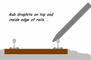

    Just a little Graphite....
    Rubbed on top and inside edges of the rails...
