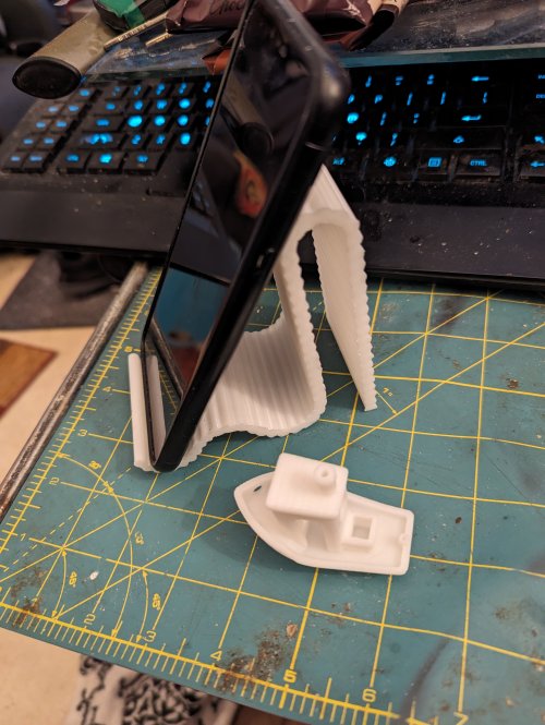

I fired up and printed out my 1st Benchy on my Creality K1 Max, in PLA. Total elapsed time was 15 minutes. One minute less than was stated. It came out great. I have printed out 2 cell phone holders I got off of "Thingverse". I learned a good lesson, don't print anything that is against that table and has a ripple edge. Lots of flashing clean up required. Not really hard, just tedious.

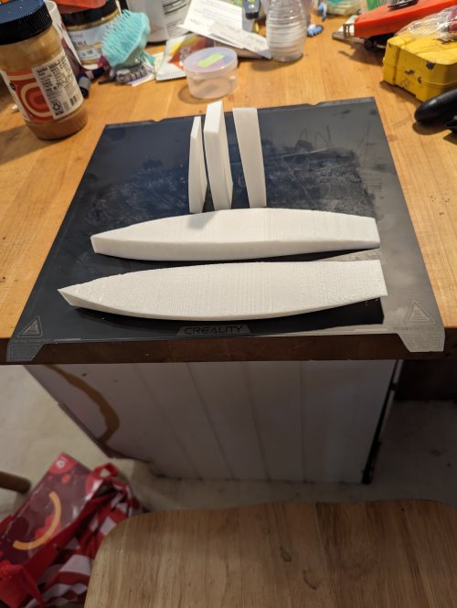

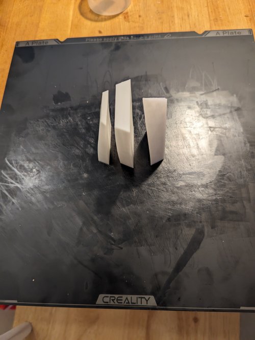

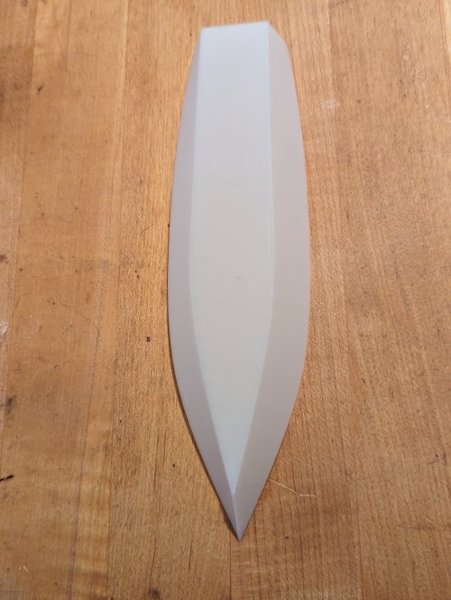

The two full Hulls that were printed right side up, then, the other, upside down. Lots of supports. The opposite sides were printed perfectly, but the bottoms, well, you can see the results.
The results of the whole model hulls used many supports, and either the top looked great, or the bottom looked great. The opposites would need a light touch with a palm, box sander.

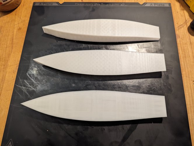

The 3 vertical pieces needed no supports, and all sides came out excellently, all models took the same about of time to print, 2 hrs. 15 mins. :)
The 3 separate pieces fit perfectly together, they would leave lines, visually, but painted, maybe just a tiny bit of filler for smoothness, and suitable models of this "New Haven Sharpie" hull be made. The next step, now that I have figured out how to convert the Mesh files from Nurbs files is to make the cut-out for the work space, rudder box, and cabin.
The bottom pic are the 3 prints, the foreground model is the 3 sections taped together with clear tape. These were made using PLA.

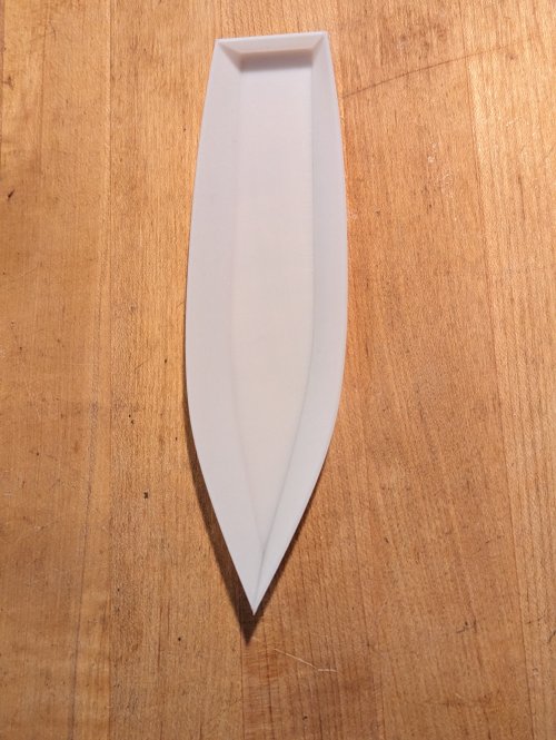

This boat was printed using no supports or infill. This is something I have not seen done much. It was converted from NURBS to MESH and then to .STL. The surfaces as almost like glass in smoothness.
What I would like to do is make the hulls in plastic, and finish the decking and bright work in real wood, as with the masts and booms, etc. ;)Open Boat No Supports 1.jpgOpen Boat No Supports 2.jpg

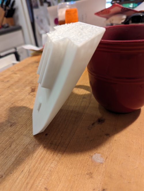

Well, half-way through the last model attempt, I run out of plastic. I have 2 more rolls coming in. I had really scaled it up, as the 1" inch models came out perfect. Now realizing you are better off designing your own stand-offs for support, and if you do a Hull at an angle, you can do the deck and top in one shot. Any doors, fo'c'sle, etc. would have to be printed separately. The brand name Creality rolls not any more expensive, and at around OOPS.jpg$17 bucks each, shipping is the same for two, so I ordered two. The rolls weight 2.2 lbs. each. This model would have been around 10 inches long. :)
