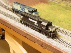

Well after reading some of these photo threads I was eager to try some experimenting with my camera. (sony dscs75) Using or try using settings from Shamus' posts. Here's what I got. Now I got to get back to work on the railroad and quit taking pictures.

A couple of nice shots you have, you haven't got too much light, your light is just about right.
