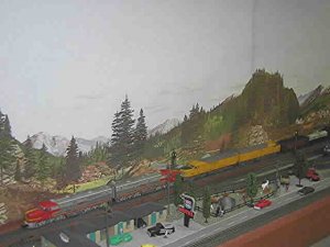

    Double double plus one
    Wayne, you gave me an idea. :mrgreen: So I put my 2 Marklin PA doubles together to get a double double. I changed the code #'s so they match. That way they can run in tandem and it seems to work well. Just for fun, I tried the Big Boy with one of the PA doubles and that works as well. So then I put both doubles at the front of a long freight and the Big Boy as a pusher towards the end. That works too. Also the reverse works as well.
    Ordinarily, with all the code #'s at their normal stations, I can run 5 trains at the same time from one transformer/controller on about 150 feet of track. I don't need dead tracks or blocks like I had with DC. I can run any number of trains at the same time from one trans/controller. I just dial in those I want to run. The rest are at rest. It's sort of like the DCC I had but better. It's a 42v AC system and seems to be adequate. I don't notice fading when more locos are added. What I like about this system is the feedback from the locos to the controller through the track. It's as if they announce themselves to the system. But as you say, the noise level can be extreme if all the locos have the sound going at once. Especially in my closed train room. A couple of pics of the above are included with this. :thumb:bob
