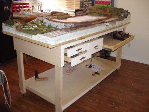

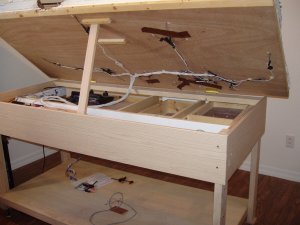

A hollow core door works fine, the nice thing is that it doesn't warp. Attaching it to legs can be a problem, but what I did was to build a frame under it and attach it to the frame using door hinges. This allowed me to get to my wiring without crawling underneath. (which is why I did it in the first place) It also gave me some room to put a couple of drawers and a place for my power packs and a future control panel. No need to go to the extent that I did, but a simple frame would work. The frame gives the legs stability, which is what you want.
Here's a few pics of my layout table:

Thanks for the pics, ezdays. That's a pretty slick setup. Gives me some good ideas for my benchwork. Hinges so you can get to the underneath easily is definately a plus.

Nice benchwork and idea. Kinda looks like my drafting table.
My luck, I'd lift it up and about half a second later hear my rolling stock and prized engine crashing to the floor.:rolleyes:
