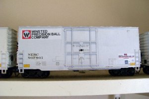

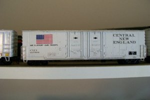

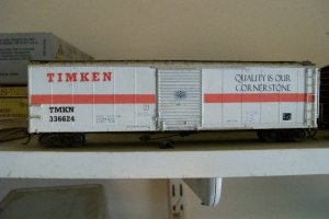

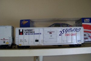

    I have great results using both the Vita-Cal system and Testors papers(I did wrie a "how to" for the E-Mag, but I think that issue was lost in the move)
    Here's some samples of some boxcars I did using both systems and my Compaq Ink-jet.
    First: the flag and "We Support Our Troops"
    Second: Timken, the moto, the reporting marks and even the stripe.
    Third: Company name, and 25 years, with the years.
    Fourth. This one was using Testors white paper. You can see the difference in the white of the paper, and the white I painted the car. Thsi only happened because I ran out of clear.
