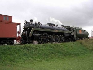

    Number 6060 does excusion runs on the Stettler to Big Valley line during the summer. Did the ride myself a couple of years ago.
    Heres a photo of 6060 ready to leave Stettler which is about a 2 hour drive south of Edmonton.

    We have been on a train in stettler. It was a wild west them and people robbed the train. (Donations to the railway.) It was a good afternoon lunch included!:thumb:
