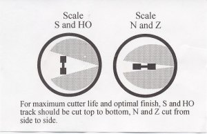

    Official
    Copy of instructions that came with the cutter.
    For HO and S, blades above and below the rail. For N and Z, blades at the sides.
    For my HO (code 100 and 75), I still tend to hold it upright and cut through the sides.
