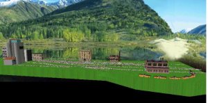

I use a really old version, so don't now if it is still around, of abracadatas 3d railroad. It has building templates track senery full 3d veiwing. anything you can do in real life this software can do. I love it. It lets you set tolerances then run test trains to make shoure there are no gaps ect. It even let me do the trench type thing.
