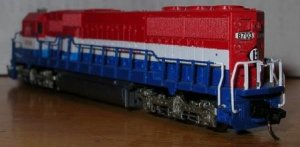

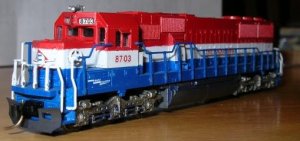

    I finally completed my little custom job
    Some pics:

    Very fine painting work sabretooth47. How many hours did it take to complete that job ?
    What paint brand , Polly Scale ?
    Do you have any plan for some ( light ) weathering ?

    Total actual working hours I'd estimate around 20 or so. In my opinion the hardest part was the taping and prepping. I added some brass grab irons and the sunshades as well. Other than that, there were no major renovations.
    Paints used (all canned spray paints):
    - Primer Gray: Testors Light Aircraft Gray
    - Blue: Testors Blue
    - White: Krylon's Interior/Exterior Flat White
    - Red: Krylon's "Fusion For Plastics" Flat Red
    - Metal: Testors Buffing Metalizer Gunmetal (for the tank and plow)
    The trucks are hand painted with Testors Aluminum.
    I don't have any plans to weather, but I may add some more "current" decals. I started the project with the idea that I may make the engine as a 9/11 dedication and I may still follow through. But I still need to find some decals that fit the scheme.
