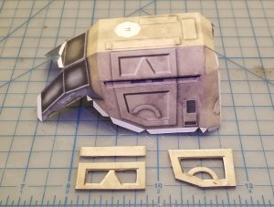

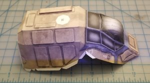

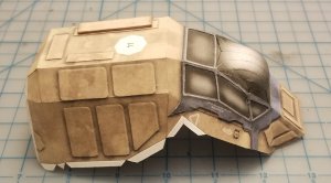

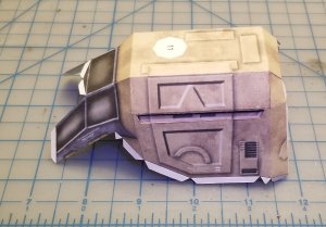

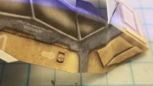

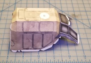

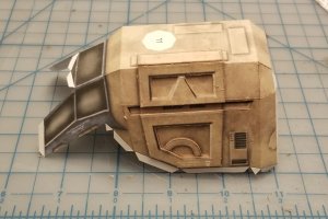

So, starting with the cabin section.

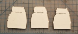

Here are the door panels.
The door panels are attached.

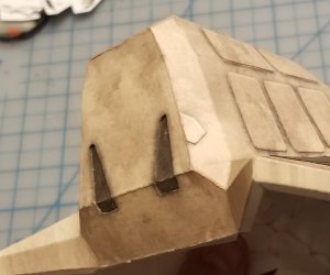

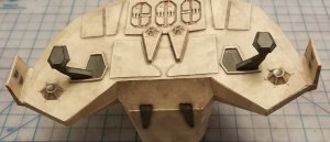

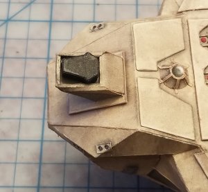

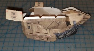

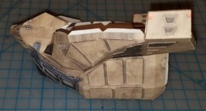

Here is the top part of the nose.
The top part of the nose is attached. I have also raised all of the body panels as well.
I raised the panels on the nose as well as augmented the "rescue" knob.

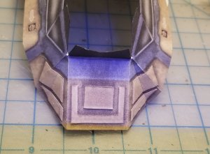

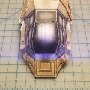

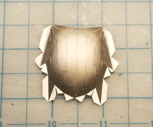

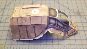

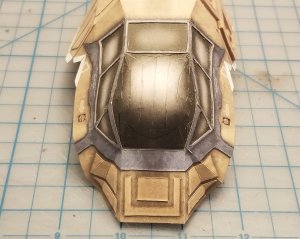

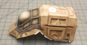

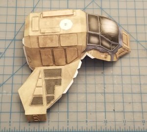

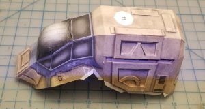

Here is front windscreen canopy.
The front windscreen canopy is attached.
I raised the frame work around the canopy

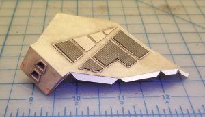

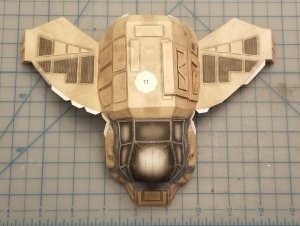

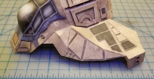

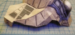

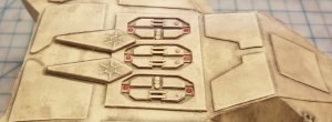

Here is a small update. I started with the upper part of the wings.
I decided to recess the steps for the wings.
As you can see, I raised the boarder around the steps and raised the regular panels and skid pads on the wings.
Here is another view to show the panels.
The wings are attached.

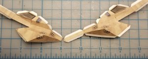

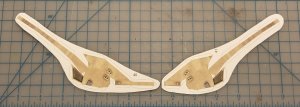

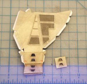

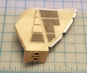

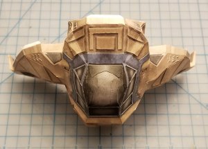

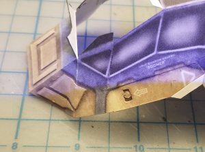

Continuing on with the underside of the hull. Here are front armoured sections of the "wings".
I raised the armour plates and the little rectangle parts that are under the plates.
Here are the leading edge parts with the mini reaction control thrusters.
The leading edge parts are framed out and the reaction control thruster panels are raised.
The leading edge parts are attached to the body.

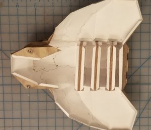

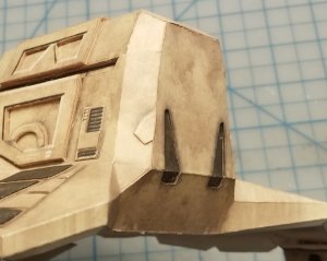

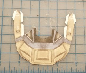

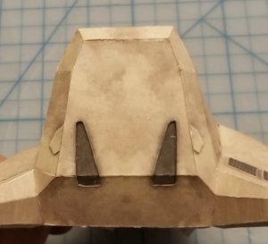

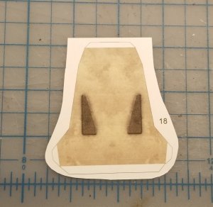

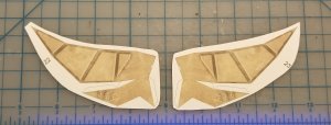

Here is the back plate
I decided to recess these dark brown triangles.
The back plate is attached.

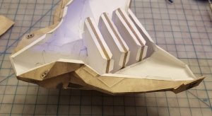

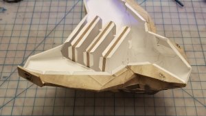

Here are the internal formers. I laminated them to about 1 cm thick.
The internal formers are installed.

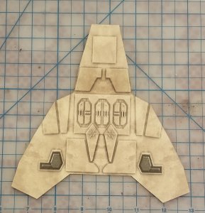

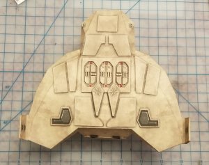

More underside work! I am now working forward to seal up the bottom.

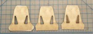

These are the outer edge pieces of the underside
The outer edge pieces are are attached.

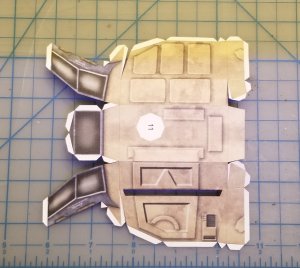

Here is the bottom plate.

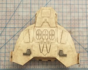

The bottom plate is attached.

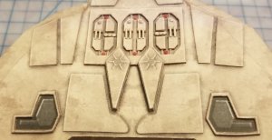

I have raised the armour plates and the underside details.
Here are close-up shots of the details.

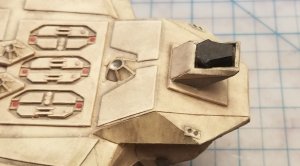

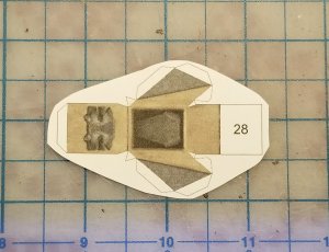

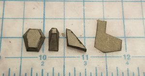

Now for the landing gear system.

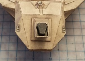

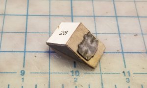

Starting with the front landing pod.

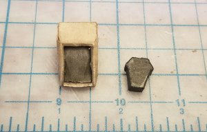

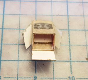

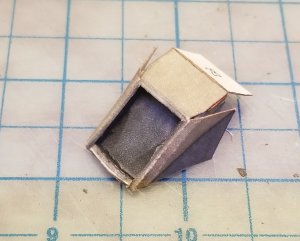

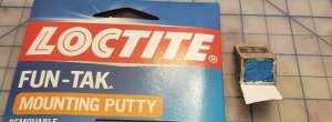

I strengthened the walls with cardboard.
I recessed the area for the pad.

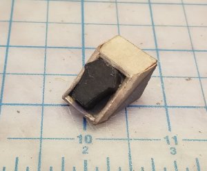

@Revell-Fan recommended that some sort of weight needs to be placed in the pod. So, I decided to stuff "fun-tak" inside. I figured since the walls were re-enforced with cardboard, I could easily fill the entire cavity with the putty and it did give it quite a bit of weight to the pod.
I sealed the top and raised the front piece of the pod.
I laminated the pad to about 5 mm and lined the sides with regular paper.
The pad is placed inside the recessed area of the pod.
The front landing gear pod is attached.

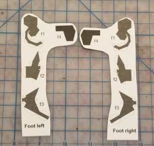

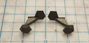

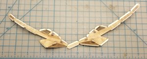

Here are the parts for the rear landing gear system.
The parts are assembled.
The rear landing gear is attached.

I really like this model but the Glass section front does it a dishonor. You may get away with a glass effect buy making a second glass piece, cutting it out, and stretching "Cling Wrap" over it, to give it a sheen. You could probably glues it over the existing cardboard glass, or cut it out of the model when it's finiished, and leave a glue tab on the model's periphery to glue the faux glass piece in. It's coming out great!!:)
12,557
9,955
I have thought about getting some gloss black paint and going over it later.
Then again I have never really liked the "doomed" windscreen. It really makes no sense to have it that way. It should have been flat.
I have the moebius plastic kit that I will eventually build. It has a full cockpit interior that I am going to use as guide to design a cockpit interior as an add-on kit for this one.
13,505
9,559
If you coat that Moebius glass with Vaseline, and stick in in bos of Plaster of Paris, you could easily pull it out without damaging it, after it dries, and use it to make a reverse plug, the same way, you coat the imprint with Vaseline, pour in Plaster of Paris, Put a stick with a nail across it, so you can pull it out, and you could pull a plastic softened sheet of plastic over the plug. You could do the same thing with 2 part Epoxy, making sure you have a thick smooth layer of Vaseline (as a release agent) to protect the original glass, them make a plug, again using Vaseline, this method gives you a much stronger plug. . ;)

The bubble screen, you really need to use a combo of the reverse plug, plus a homemade vac-u-form. I made mine out of a few scraps of plywood a couple pin hinges and hooked to a small wet/dry vac.... use a toaster oven to heat up sections of vacuum packaging set in a frame, and just press down hard by hand when forming... plug can be just plaster as you only need 1 or 2 < just in case...
Reactions: Rhaven Blaack
12,557
9,955
I have seen this technique done before. I may give it a go as well. It will be useful for other domed (or bubbled) canopies for other projects.
Thank you for sharing this!
13,505
9,559
It would be easier to make the section out of cardboard, reenforce the back side, and heat some sheet plastic, and pull it over the plug, and trim. Very fast, and looks great. :)
